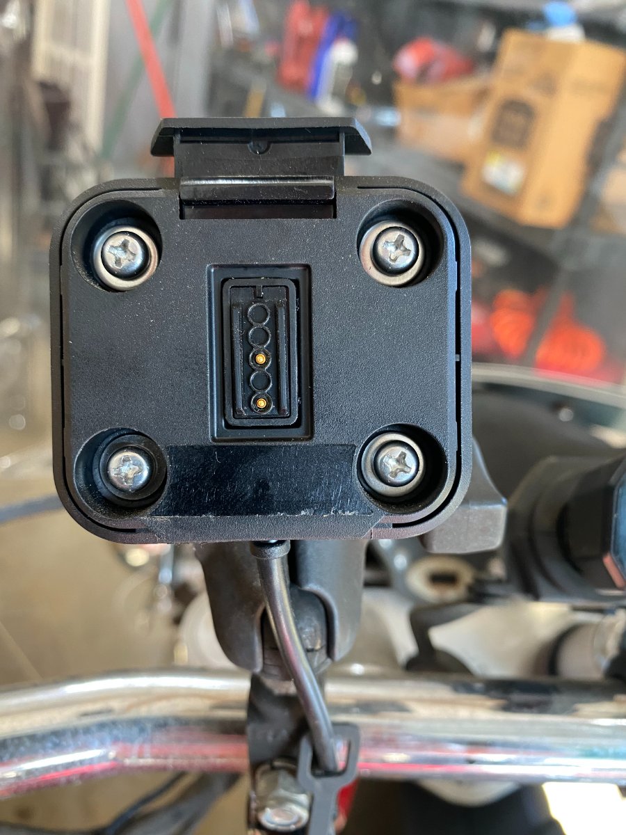

:!: :!: **HELP** :!: :!:
I've read the first couple of pages and the last couple...admittedly didn't read the entire thread, so can't say for sure if this has been addressed already.
First, it appears I have the "new" cable.
Don't know why it posted sideways...
But, when I turn the motorcycle key on, the XT will power up, but it appears to be running on the battery. Also when I try to turn on the fuel tracking it is grayed out and says it must be in a motorcycle mount.
So apparently it's not getting any power. Although the middle pin shows 5.25v when I check it. Not sure if that is the amount it is supposed to have or not.
Any suggestions?
When I first installed the mount I turned the key and the XT powered on...I figured that was it. I didn't think to check anything else while I still was inside the headlight bucket :?
For the record this was purchased directly from Garmin less than a month ago.
