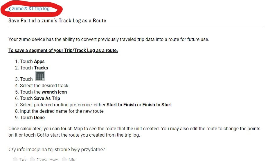

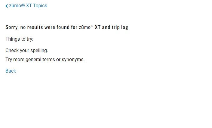

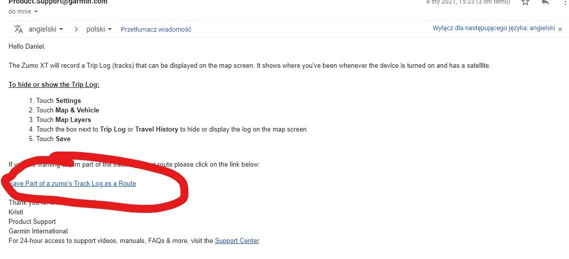

We have another clue - garmin is hiding something
I tried to force garmin support answer my questions.
They sended me only part of manual
picture 1 with this link
https://support.garmin.com/en-US/?faq=s ... tab=topics
You can click and see this,
picture 2 but when you click "ZUMO XT trip Log upper left you see that page is removed, you can't see this from normal www tree
picture 3
picture 3
