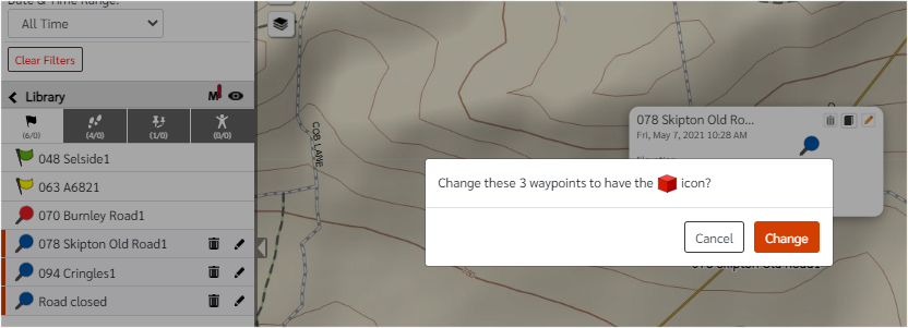

In Explore website, select all of the Waypoints that you want to change in the collection / Library pane on the left
(on PC, you click one, and then CTRL click the others you also want to select)
Then click on the pencil / edit icon for one of the selected waypoints and change it.
You wil get a message asking to confirm that you want to change x items.
Synch the XT with the Explore account again.
In the screen shot (click on it to get a larger image) I have selected the bottom 3 waypoints from the list.
