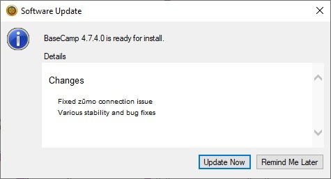

Re: Garmin zumo xt crashes basecamp
Todays screen shot from Basecamp for PC
21 May 2021
21 May 2021
