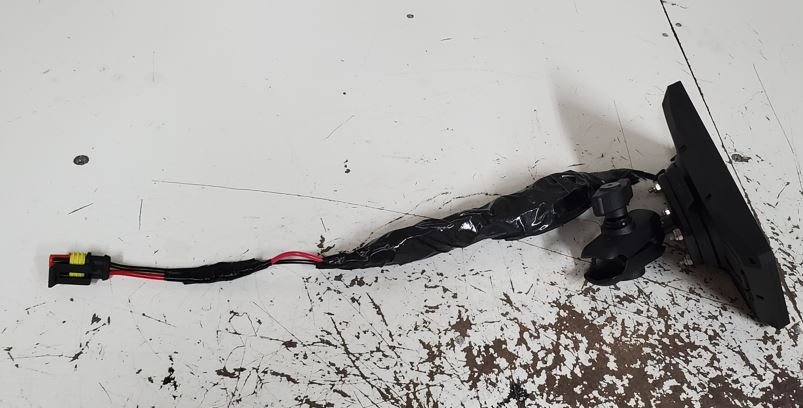

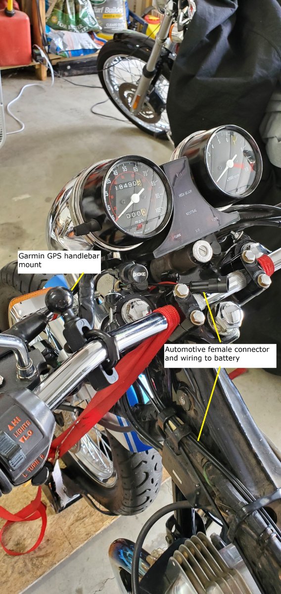

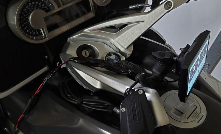

Hi Stu, I received a replacement connector from Garmin quickly and at no charge. That's nice but I really didn't see much in the way of design improvement. So I decided that I would add an automotive grade water proof connection at the other end. That way I can leave the Garmin mounted and move from bike to bike using a RAM mount and an automotive connector. Hopefully, the pogo pins will last longer if I don't have to interface with them very often. I wanted the capability to easily move the Garmin from bike to bike so this should work well for me. It isn't the most elegant solution but I believe it's robust and weather proof. The nice thing is if the automotive connector fails out in the middle of nowhere, it can easily be fixed.
Garmin XT change.JPG (55.55 KiB) Viewed 7886 times
Garmin Connection now.JPG (65.36 KiB) Viewed 7886 times
BMW Setup.JPG (56.97 KiB) Viewed 7886 times
