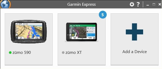

Except - this is not the case if you click the Zumo XT icon - if you have one - on the home screen. Eg - I have two Zumos set up - my %90 and my XT - so my home screen looks like this.
Clicking the 590 allows you to install the maps to PC OK. If the Zumo XT is plugged in, clicking the 590 icon allows the map to be installed to the computer.

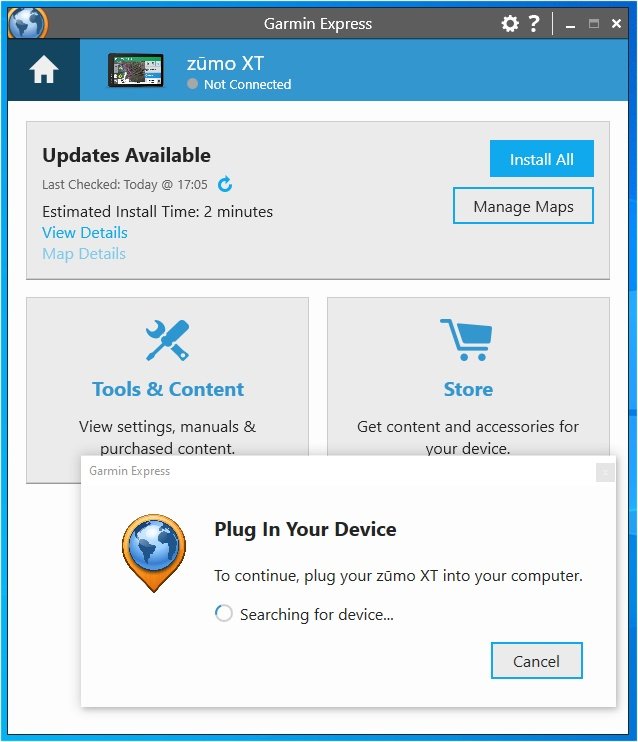

If you click on the XT, there is no option ot install to the computer AND any attempt to access either of the map links forces you to connect the XT before it will go any further. Like this:

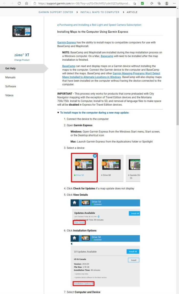

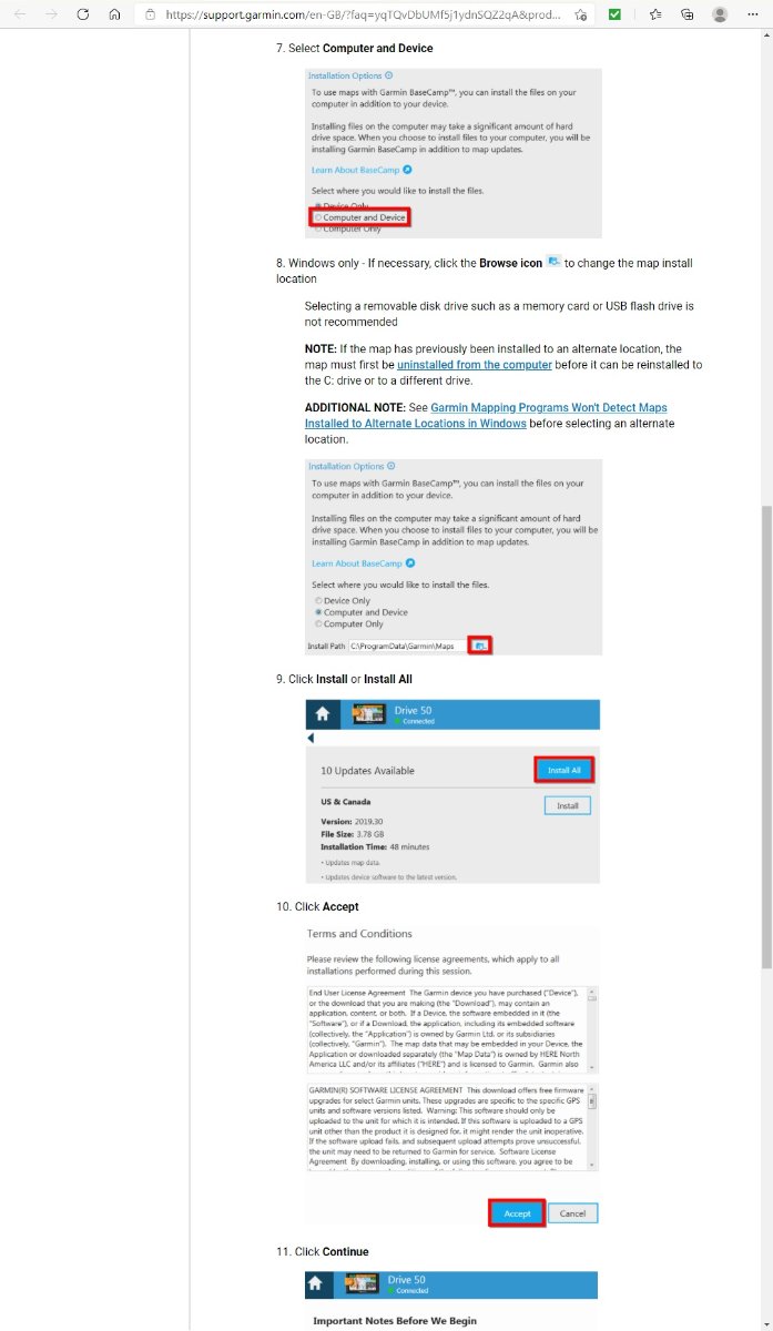

Just for future reference. When I reported the issue on 16 March - as I hope many others have done, I was asked a number of questions and was given this link:
https://support.garmin.com/en-GB/?faq=y ... tab=topics
It is a page which describes how to install the maps to the PC - in the same way that I did when I first got the XT, and for the subsequent update. The page specifically shows image of the XT on the left hand side, and labels the page as for the XT. But technical support were clearly indicating to me that this was the way that I should be able to do it, and I was indicating to him that I knew that, but the facility had been removed in the latest version of Express.
I have lodged the 2 screen shots below as a source of reference, because web pages can change, and my suspicion is that this page may change before long. I hope that I am wrong, but this omission may well be deliberate. In which case the Zumo XT for me will no longer be fit for purpose, and will no longer do what it's documentation says that it will do.
The images below have been reduced by the forum software, but if you right click and copy the image, it will allow you to paste a readable sized image into a document.
