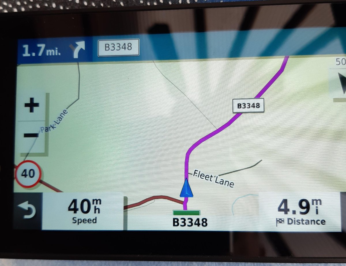

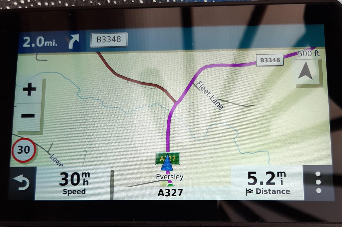

I am trying to understand why in this example the next turn information, top right, shows to turn on the B3348 in 2 miles when I am on the A327 an the turn onto the B3348 is about 500 yards away. See the first picture. In the second picture you can see I have turned onto the B3348.
So what is missing is the turn onto the B3348 from the A327.
I have reproduced this using the offline mode.
Please let me know if this is not clear.

- 20210903_164028.jpg (180.17 KiB) Viewed 3258 times
- 20210903_164104.jpg (184.26 KiB) Viewed 3258 times

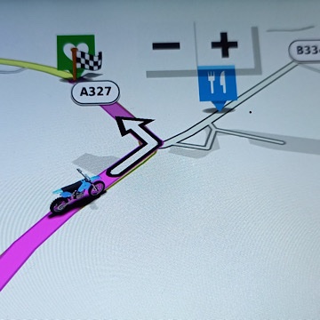

That has got to be a mapping error. My XT does the same thing at the same junction, under simulation.
Turns like that where you expect to receive spoken and text instructions are always accompanied by a white arrow superimposed on the magenta route. There is non. The road appears to be straight on, although the mapping does show a little kink.

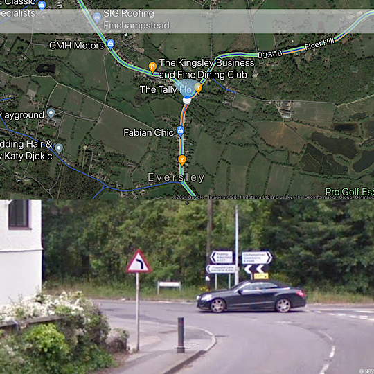

I looked on street view - it is most definitely a right hand turn at that junction - you knew that, of course, but others do not.
This sometimes happens with junctions that appear to be straight on. This doesn't show up in either direction for that route, but if you plot your destination north west of the junction on the A327, then that does show up the white arrow, and will give directions.
The mapping has the priorites for that junction wrong. Theres nothing that garmin can do about that. The map providers need to be informed if it is to be corrected. Someone will have a link to it. I'm a bit hampered away from home with just an ipad at present.

Jheath, thanks for taking the time to validate this, not sure what you mean by Google. If I map a route through that junction on Google maps it gives me a correct turn indicator

Tried this using BC with the same map and the turn directions also miss the turn onto the B3348
Recalculated this route using Open street map, and that does show the correct turning to the B3348
So conclusion, it is the map, and the money you pay Garmin for their maps are worse that Open Street map.
