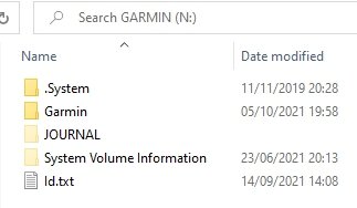

If you look to the GARMIN drive letter (N: in my case), you should see some folders.
GARMIN folders.jpg (10.91 KiB) Viewed 3680 times
Mine looks like this. The feint ones are hidden. My .System folder WAS hidden, but I have made it visible.
But you will probably only see the Garmn and JOURNAL folders.

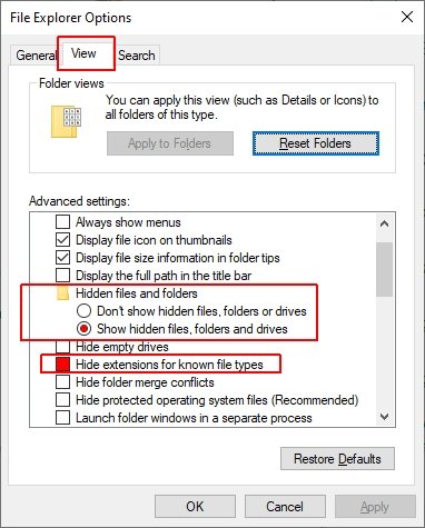

So, you need to make your hidden folder visible.
Find Control Panel and select File Explorer Options
This will open up this dialog box.
Click the View Tab at the top.
File and Folder Options.jpg (45.63 KiB) Viewed 3680 times
Select Show hidden files, folders and drives.
Not essential, but while you are here, you may also want to untick 'Hide Extensions for known file types. This is the setting that allows you to see a full filename such as Current.gpx rather than just 'Current', and MyPhoto.jpg rather than just. 'MyPhoto'. I find it helpful to know what type of file it is.
Now go back to view what is on your GARMIN drive (my drive N:). You may need to refresh the display, or select a different drive letter, and then go back to the GARMIN drive letter.
You should now be able to see the .System folder. It will probably have a feint icon.

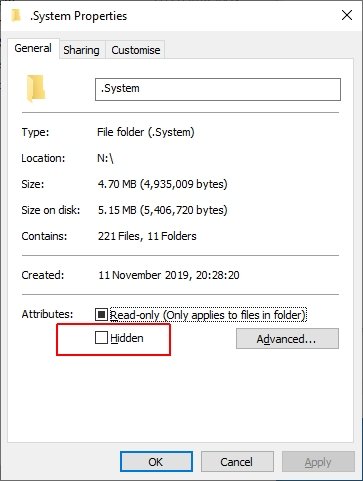

Now you can Unhide the .System Folder
Right click on the .System folder and select 'Properties from the pop-up menu.
This dialog box appears.
System Properties.jpg (26.42 KiB) Viewed 3680 times
Untick the 'Hidden' property.
Now whenever you view that drive letter on the Zumo, you will be able to see the system folder.
