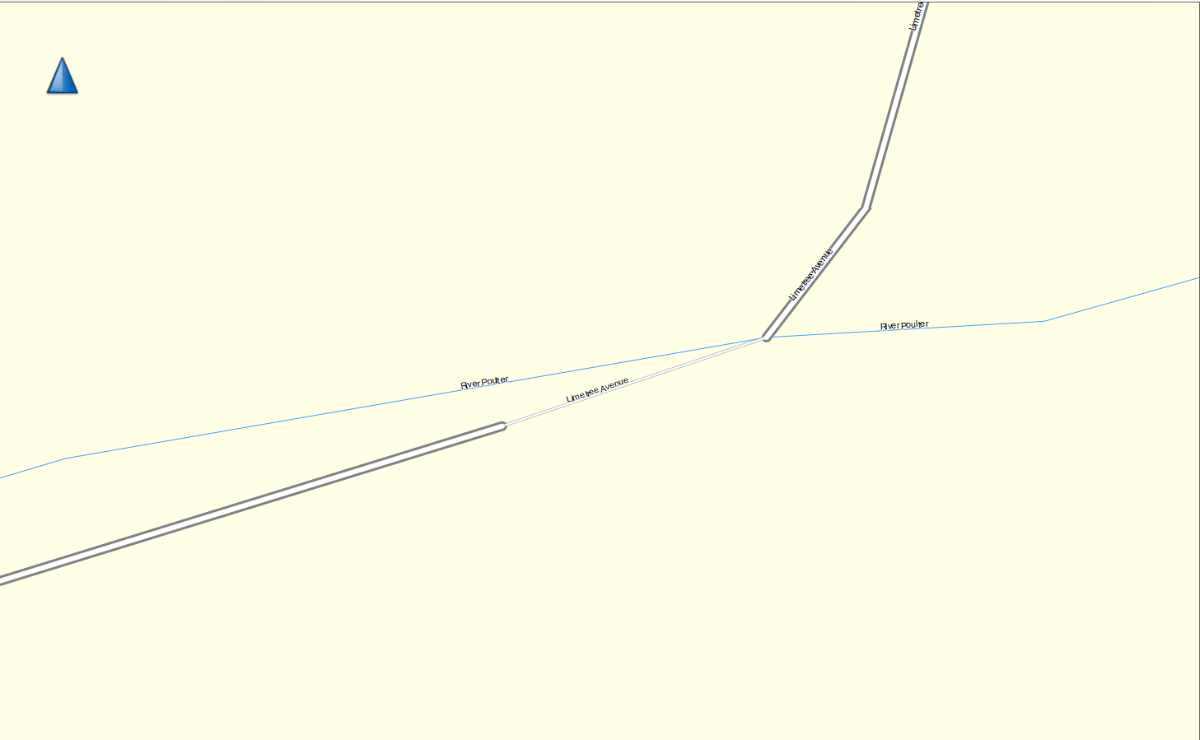

eureka!!
Found the issue! Google and TomTom maps are correct and Here maps is wrong :roll:
Here maps shows it as no through road when in fact it is and even on street view it shows cars on it :lol:

Yet BaseCamp allows routing using the activities I mentioned above. Either Garmin is using an earlier HERE map or Garmin have corrected it.
