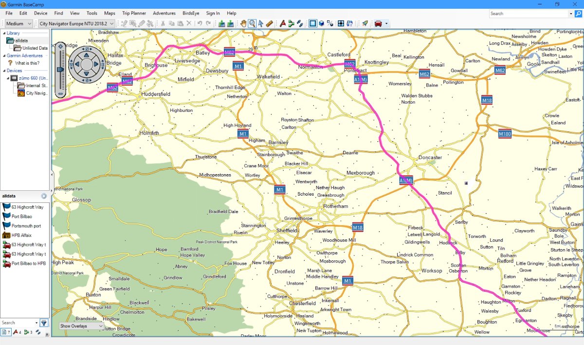

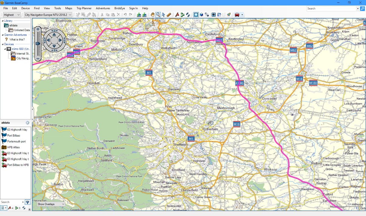

Here's a picture with medium detail and then maximum detail. There is a lot of difference: You can also see the toolbar at the top which shows the map and the detail level.
medium detail.jpg (213.62 KiB) Viewed 6922 times
Max detail.jpg (310.37 KiB) Viewed 6922 times
