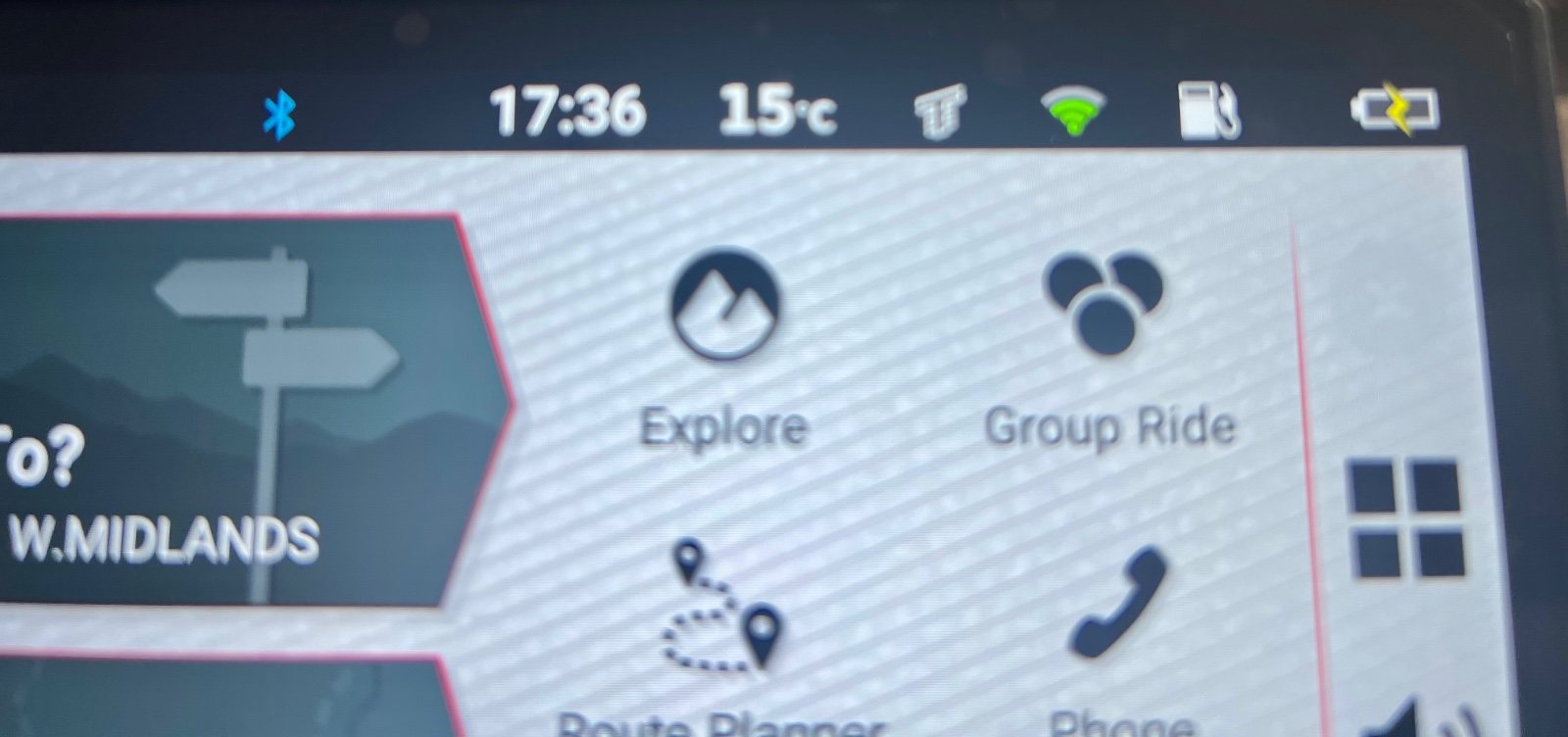

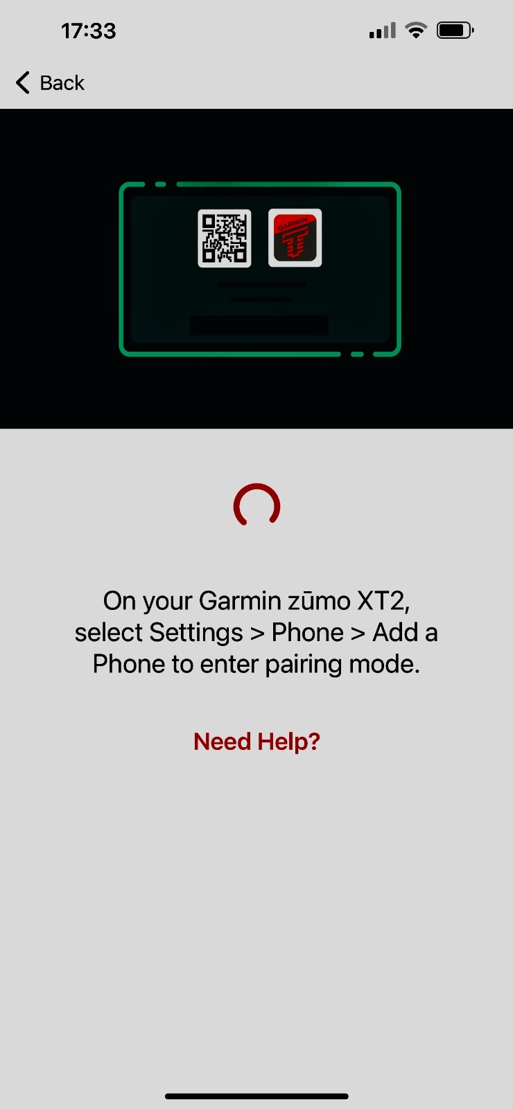

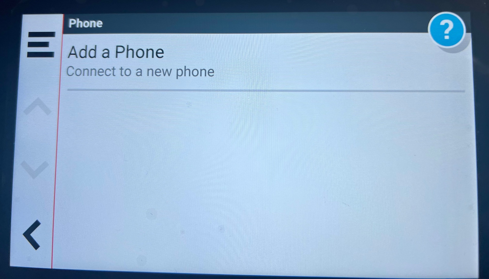

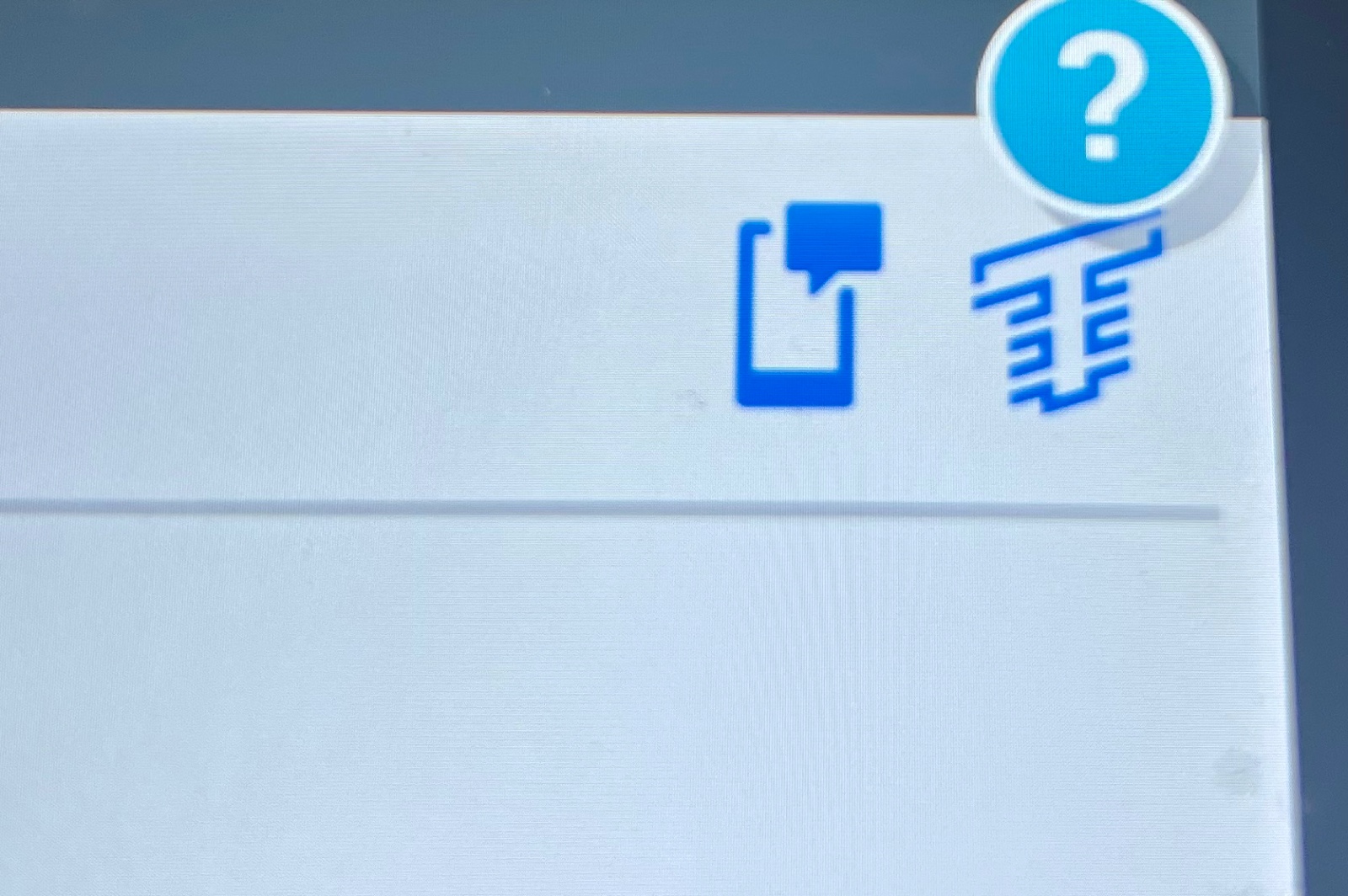

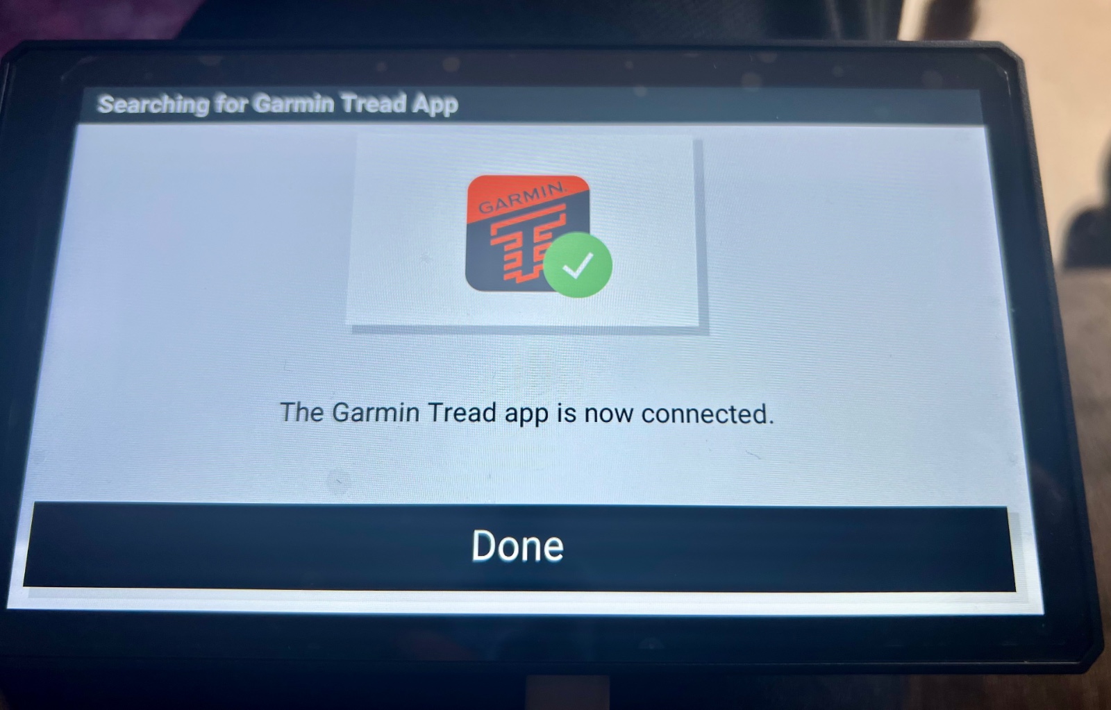

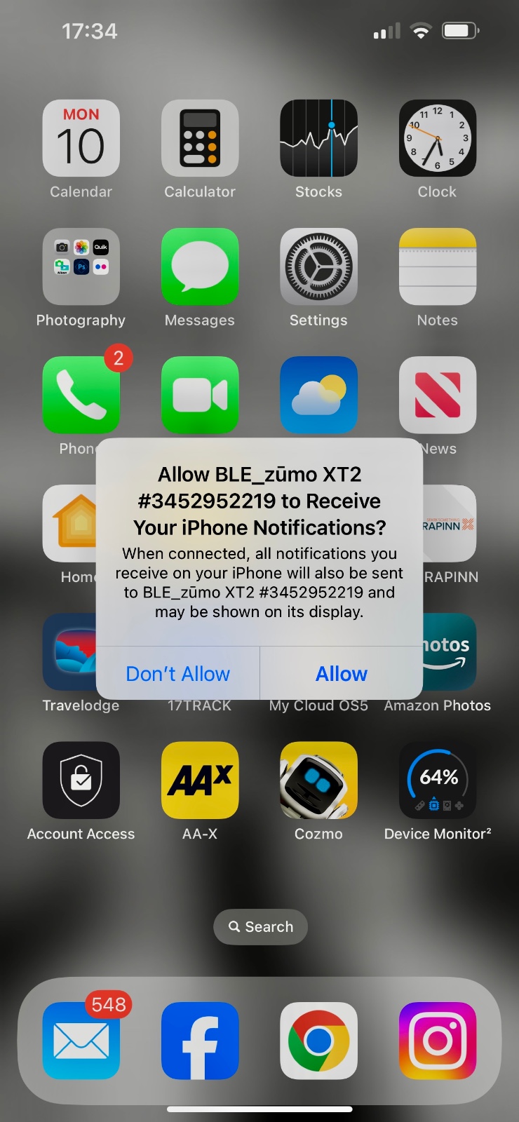

I had another play with it yesterday evening, first I deleted all the connections on my iPhone and then the same on the Zumo XT2.
Then a new connection from the Tread app to the phone.
Same as before a partial connection, but no thread app indicator on the Zumo XT2.
So deleted both connections on both devices.
Then also deleted the Tread app on my iPhone.
Once again used the newer download of the tread app to make the connection between the Zumo XT2 and the iPhone.
This time it seemed to pair quickly, and moved past the pairing section on both devices quickly.
Here’s the he pics of the phone and the Zumo XT2 with the now fully highlighted Tread app icon displayed.
