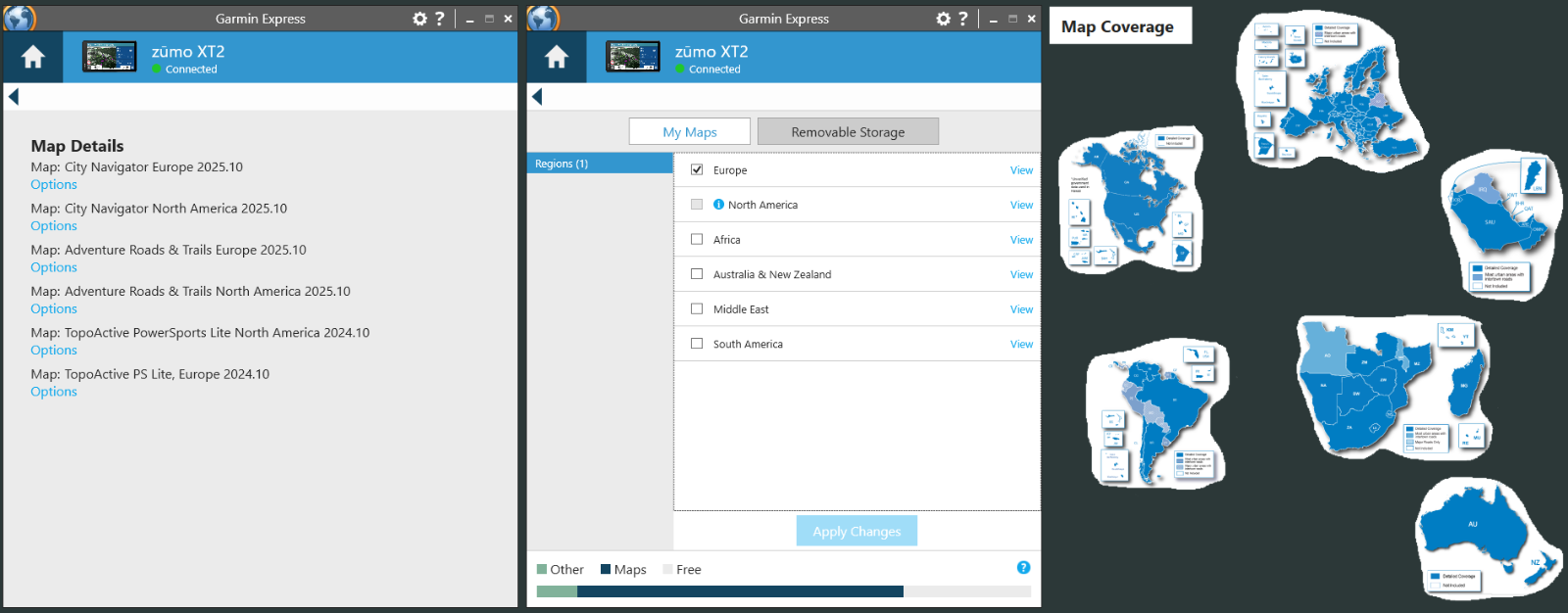

Zumo XT2 : Install Map Options - Garmin Express
Posted: Wed Jun 05, 2024 10:54 pm
More Maps.png (270.72 KiB) Viewed 7450 times
Thats right - mine came with Europe, N America (Mine is on the SD Card), Africa, Aus and NZ, Middle East, South America
Maps are not drawn to scale. No. Really.
I had a feeling that when I bought mine, it didn't feel brand new. I don't mean second hand - but perhaps out on display. Everything was there, the sticker was on the screen, but one of the bags inside looked a bit tattered. The contents ratteled around inside, but the Zumo itself looked brand new and I couldn't find any evidence of it having been used when I connected the USB cable to inspect the folders. I just had a feeling.....
So I am not sure whether this collection of maps comes with every Zumo XT2 or not. But they certainly came with mine, and I wasn't expecting it.
Eventually, I will collect these notes together and place them in sequence in a brand new thread.
