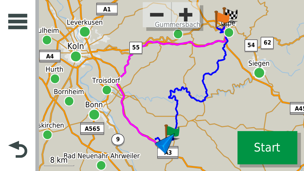

What exactly is wrong with this shaping point?
From my point of view, a well-functioning CEP should be able to handle this.
You know there is a pizzeria on the way, you just want to drive past it, but if you are hungry and it is open, you stop there for a break.
The route tracker knows this too, and everything is OK during the check before the trip.
Then you need the CEP function and that's exactly when you get a problem?
Sorry, but this kind of software behavior is not acceptable, and it's certainly not a route planning error on the part of the user.
Posts: 983
Re: Looking for the best start option to begin a planned route.
proofresistant wrote: Fri Jul 25, 2025 12:07 am What exactly is wrong with this shaping point?
Well. In the 1st place I did not meant it to be there, it should have been place at the main road. Bruchstrasse. My fault I did not pay attention.
2nd When driving you need to turn right, make u-turn, turn right again, just to be on the same road.
3rd When starting the route from my current position with CEP it skipped nearly all shaping points and wanted me to take the Autobahn.
4th If the Shaping point is moved to the Bruchstrasse all is well.
Besides I dont like Pizza!

proofresistant wrote: Fri Jul 25, 2025 12:07 am Sorry, but this kind of software behavior is not acceptable, and it's certainly not a route planning error on the part of the user.
Agree 100%. But that's how it works. Just wanted to warn you about this behaviour.
