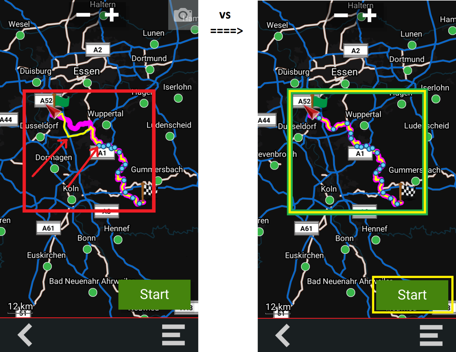

I often have the problem that I cannot operate the zumo XT2 in such a way that the XT2 navigates me to the best possible start of a route with shaping points from my location. :-(
What am I doing wrong?
I have simulated an example.
Scenario, example:
I have planned a route with shaping points.
I am on the route (or close to it), a few kilometers after the start and between 2 shaping points.
Now I want to start or restart the route.
Result:
a)
I chose at the beginning in the "Next target Menue", start at the 1st Waypoint (beginning of the route), then it navigates me back to the start so that I can then ride back to my starting point. But I don't want to go back to the start :roll:
b)
I chose at the beginning in the "Next target Menue", start at the closest point of the route, then it navigates from my position, but it also likes to skip one or 2 shaping points and get in somewhere. :o
You can even see that it there a shaping point nerly back, that I have already passed.

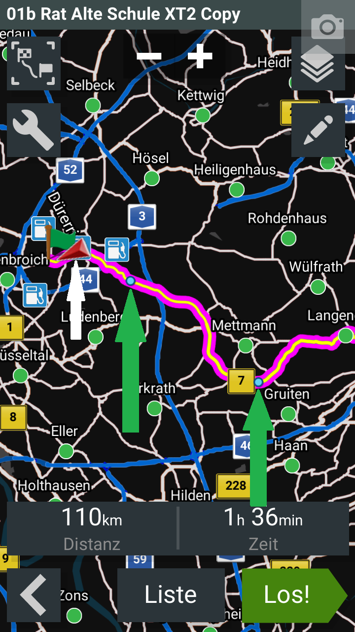

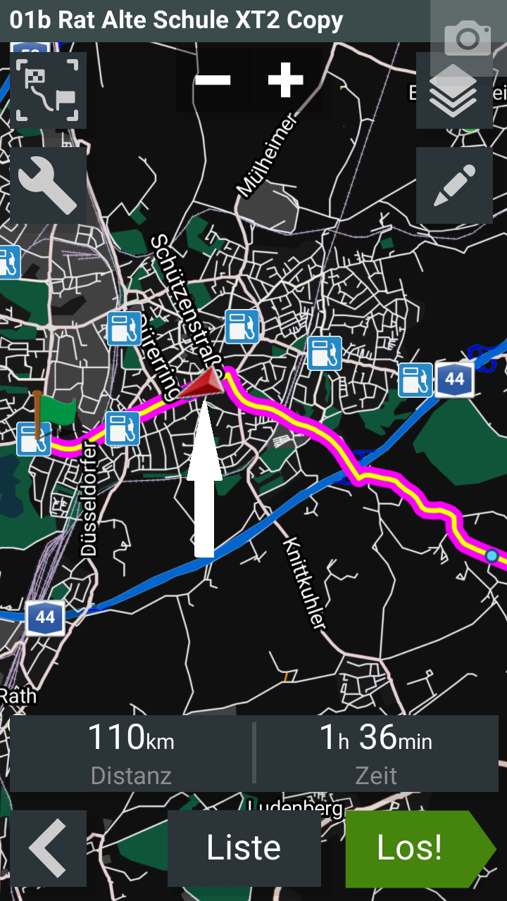

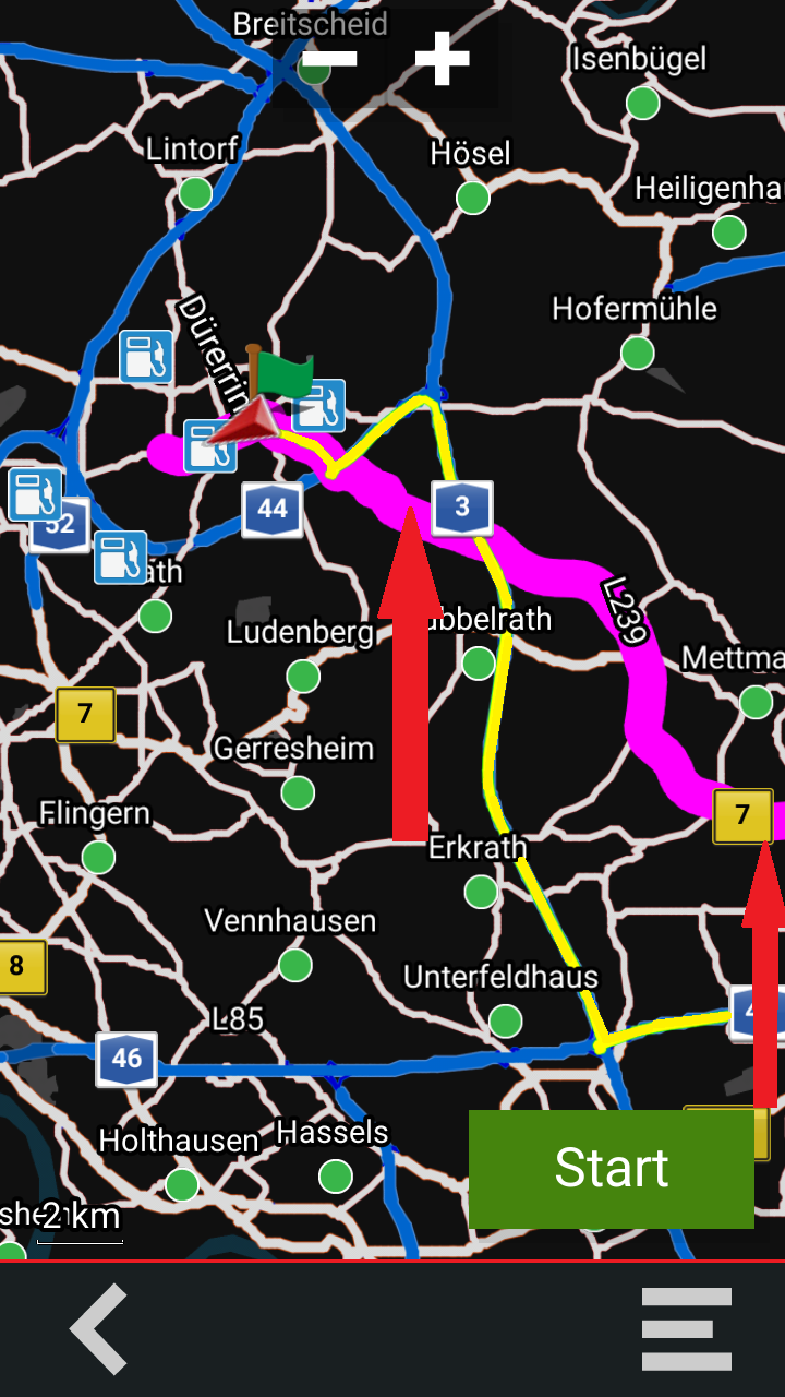

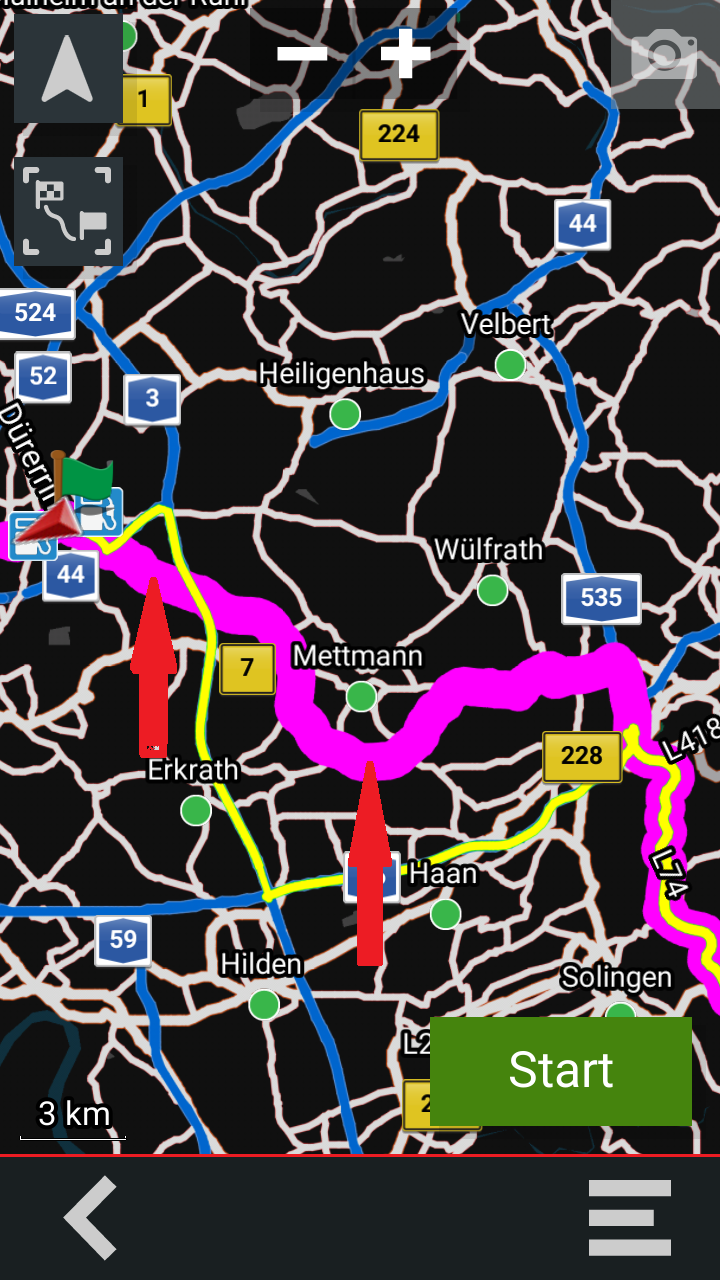

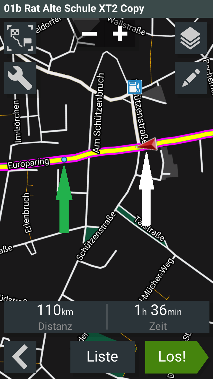

Here is the result b with screen shots:
Yellow Line is the selected planned and then the currently new calculated route with nearest entry point.
Magenta Line is the planned track.
Painted green arrows are the planned shaping points.
Painted white arrows are my current location.
Painted red arrows are the then ignored shaping points
What am I doing wrong or what can I do better?
PS
I hope I'm not opening this topic again,
If so, please let me know ;-)

Your last image - It seems to have decided the the closest point is where the yellow and the magenta line meet up near the 228 sign at the right of the map. Becasue it has decided that, it has drawn a new route from your current position to the 228 location and continued from there. In calculating the new route it ignores any route points that were originally plotted.
So everything fits with what I would expect. Except - from your position, that 228 is clearly not the closest point.

The requirements for CEP behavior are probably even more complex than expected.
I now believe that a route copied and calculated as described by @smfollen will be problematic for CEP, and that, as in my case, a different but equally corrected route will work better with CEP.
One reason for this could be the subclass tags.
I had an example where, instead of the BaseCamp standard default values <gpxx:Subclass>000000000000FFFFFFFFFFFFFFFFFFFFFFFF</gpxx: Subclass> I used the standard values as used by the Tyre program <gpxx:Subclass>0600D88F0C0249D70B00211600001F001F00</gpxx:Subclass>.
Importing such a GPX with Tyre default values via SD usually takes up to 15 times longer, sometimes several minutes (may immediate conversion).
With another test route, I am currently unable to obtain a usable CEP result either by copying or recalculating. In the new example, CEP completely avoids all shaping points.
I want to share the result and the sources here when I have them ready.
What I have found out with relative certainty:
  • CEP can find the best entry point between via or shaping points or the track in between.
  • The import flag has no significance.
  • The source of the route has no significance.
    Perhaps those created in the XT2 or Tread app work better
  • The position and, above all, the viewing direction have no significance.
  • CEP works very well for the next VIA point.
  • CEP sometimes does not work for the next shaping points.
  • Recalculation can improve it, but unfortunately not always.
Best workaround from my current experience:
  • Copy the route so as not to damage the original.
  • Take the nearest shaping point you have and to which you want to drive, then change it to a Via point.
  • (idea not yet tested) If you don't have any shaping points and only a route from A to B, try to create a new route from the track, which you hopefully have as a backup.
