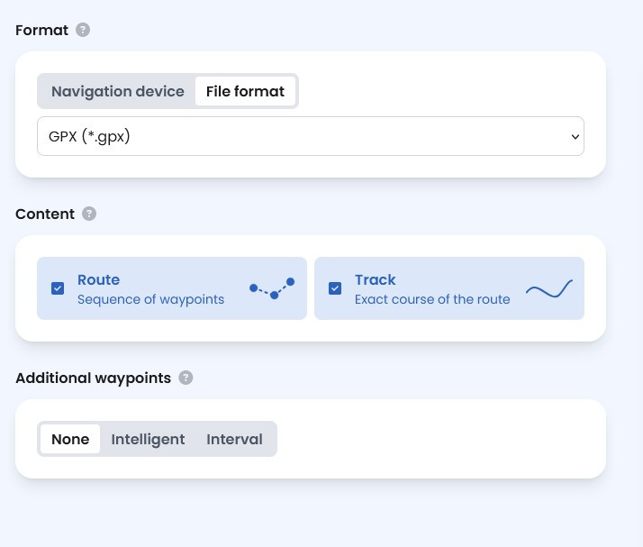

I see no advantage(s) in using anything other than GPX.
XT and XT2 just add a lot of gpxx:rpt that the XT does not use, it only takes long to recalculate.
In my test there was no difference between standard GPX and GPX advanced.
I would recommend to tick the checkbox to include the track, so you can show that on the map.
To have additional shaping points, set Additional waypoints to Interval.
(@jfheath Yes I know the term Waypoints is used incorrectly according to Garmin standards)

Peobody wrote: Tue Jan 13, 2026 4:32 pm I did not include the track but my first export included additional waypoints set to Interval. BC errored on import attempt.
Choose "File Format", not "Navigation Device"
Set the type to *.GPX
My route imports in BC

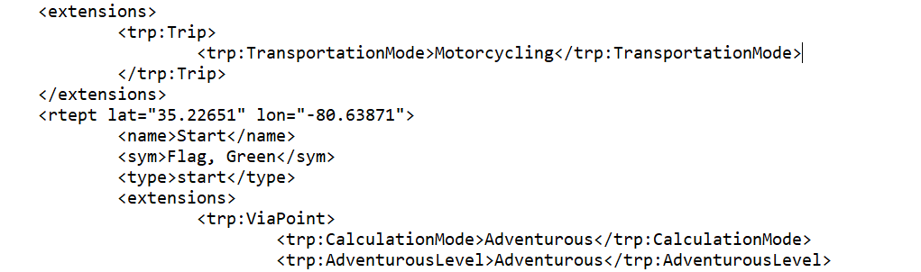

What BC does not like is the AventurousLevel that is emitted when exporting type: Navigation Device = XT
Code: Select all
				<trp:ViaPoint>
					<trp:CalculationMode>Adventurous</trp:CalculationMode>
					<trp:AdventurousLevel>Faster</trp:AdventurousLevel>
				</trp:ViaPoint>
TripManager has no problems with that, so you can send the GPX directly to the XT, without importing it in BC

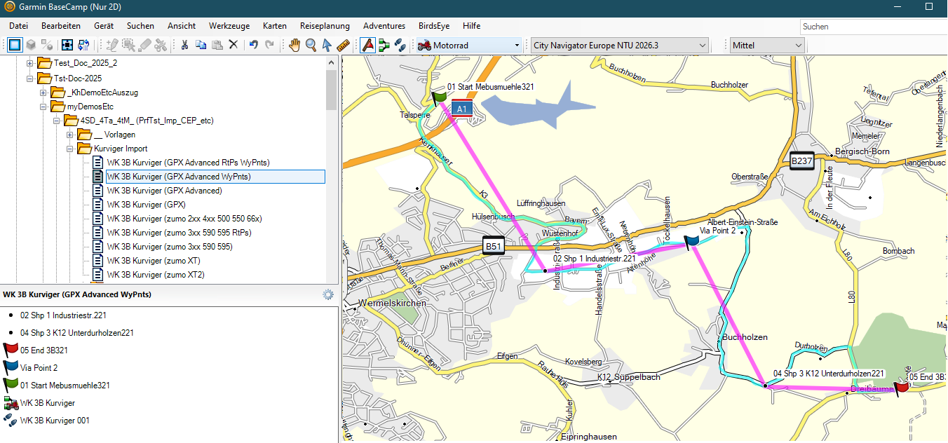

I choosed "File Format" but i set type to GPX Advanced, with Waypoints
Route will imports in BC also, looks like:
GPX Advanced Way points.png (411.03 KiB) Viewed 349 times
Then was AventurousLevel not included also.

FWIW, the two of mine (exported as device=XT) that would not import into BC contained this:
