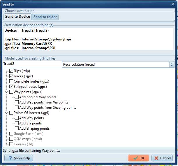

It looks like routes and GPX files from Kurviger https://kurviger.com/ can be transferred with TripManager also :)
At least in principle; I have currently tested it with my Tread 2 device.
But i noticed that only the option with recalculation actually makes sense.
The other options i didn'd testet, because i didn't found ghost points in the GPX Files from Kurviger and require recalculation.
In my opinion, it probably also makes sense to have routes from other sources recalculated in the device :idea:
I would recommend checking the calculation mode for route in the device, because although I used “Fast” in Kurviger, but “Adventurous” (without the second additional attribute) i found in the GPX file.
Then I noticed a "suboptimal feature".
Kurviger can also export the track in addition to the route in the GPX file.
However, the track then has the same name as the route.
If I now select the route and track from the GPX file during TM transfer and I want to transfer both the stripped route and the track, “only” the track of the route (which unfortunately is not a track due to missing waypoints) is transferred and the “real” track with the same name is missing.
Here is my question for @FrankB:
Could an option be added to TripManager so that if the “real” track name in the destination GPX “Tracks_*.gpx” is already used by the ‘route’ track name, the real track will saved with a suffix (e.g., may ” 2") in the GPX olso?
By the way, same Names for Route and Trip can be content from BC also ;-)
TM used SendTo Options.png (63.68 KiB) Viewed 660 times
Here is an example of what a GPX file looks like when saved from Kurviger.

proofresistant wrote: Fri Jan 09, 2026 10:08 pm Here is my question for @FrankB:
I will look into it. I agree that it is not useful to send a track with no <trkpt>, while there is a complete track in the original GPX.
In this case I would also prefer the track, and not the route. Would that be a solution, if TM also prefers the track?
Btw: For stripped routes the route is always taken.

Yes, if so, preferably send the track, that would also be OK.
Then, I don't really use/need the complete route as GPX.
When I import GPX into the device, I somehow prefer the stripped route, I mean stripped routes are imported faster and have to/should be recalculated in the device anyway.
