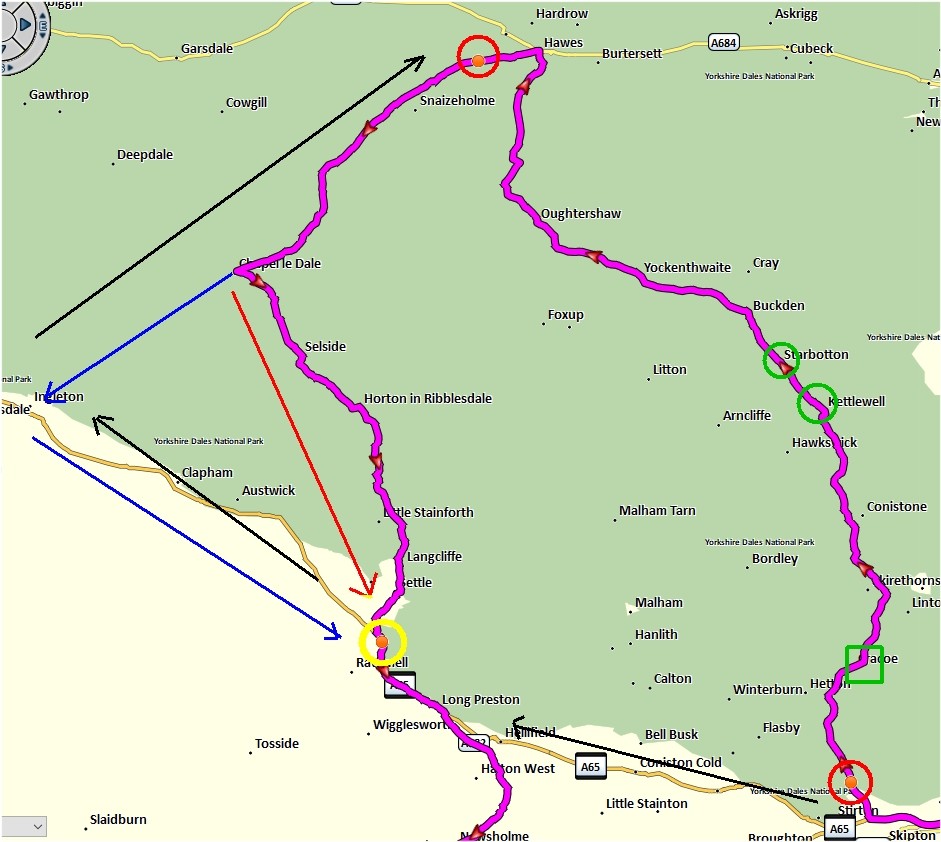

The attached picture - (click to see a bigger image) Shows the test route in Magenta. Starting before the bottom right with two route points - the start, which I will pass through a couple of minutes after setting off. And another route point which I will skip before I get to it.
This may or may ot be necessary, but I know that when I do that, normally the never ending RUT loop will start as soon as I deviate from the plotted route.

Previously
The navigation would be OK travelling up the right hand side until I reached the most northerly point on the map and the first Via Point - red circle.
I'd then travel south west to Ribblehead - the point where my intended path heads south (ish).
But skipping that earlier via point has caused the XT to recalculate the route and from the most northerly point at the top of the map, it will want to take me SW along the blue arrowed road and then SE along the A65 blue arrow, in order to get to the next Via point at the yellow circe. It is the faster road according to the satnav, but it isn't the route that I plotted in Basecamp, and it isn't the route I want to take. I will take the magenta route shown on the map, and by the red arrow.
Immediaately it starts asking me to go back. To U turn, and it does that repeatedly all the way to Settle - which is about where the end of the red arrow is near the Yellow circle. Its route is to go back all the way to Ribblehead, and follow its blue arrow route - to do 29 miles to get to the location that is a mile in front of me.
More recently.
The last test I did was the same route, but for some reason it wanted to double back after the first Via Points at the bottom right of the map, and take me to the red circle Via Point at the top of the map. It wanted me to go along the faste A65 - shown by the three long black arrows.
I tunrned the volume down - but it kept demanding U turn after U turn all the way to Oughtershaw when it gave up an naviagted ahead. I thought that it had given up and that it was no longer in a RUT but was doing the sensible thing. No. I rode through the Via Point and the XT was showing it was about 15 miles ahead. It was routing me all the way to Ingleton where the blue arrow ends at the left hand side of the map, turned me round in a hosuign estate and then ent all the way back to the red circle. It was still remembering its original route. And either it thought Ingleton was the closest point where I could turn round, or the Via Point has to be approached from the originally intended direction. I did pass through it, but I was going the wrong way for it to recognise the fact.

I have two routes planned. Both have been prepared on Basecamp, transferred and Imported. Both have had the byte in the trip file changed so that they think that they are a saved trip rather than an imported one.
One is as described and as shown by the magenta line. It will have been recalculated by the XT when I press Skip just after the start.
At Cracoe - Green square - if I place the bike there (in simulation), then the XT calculates that the magenta line is the fastest way to get to the Via at the top of the map. So I know once I reach that point it should calculate ahead - If I get to Kettlewell and it is still asking me to go back, two things will happen.
1) I will be very disappointed.
2) I shall abort the route and stop the bike ahead of the green circle which will be the start of the second route.
So from just before Kettlewell, setting off towards the Top red circle Via Point, I will pass through the first green starting point and then skip the next green circle Via Point. This will set up the route to normally start a RUT loop when I head south down the red arrowed road - because the satnav will want me to go to Ingleton.
Whether I am still on the original route or I have had to start the second route, once I have passed the most northerly red circle Via Point I will be heading for the sharp left hander at Ribblehead following the magenta line on the map and the red arrow. Ignoring the magenta line on the satnav (blue arrow) - which it recalculated when I pressed Skip.
I will know instantly I turn. It will either tell me to go back, and begin a RUT loop for the next 10 miles or it will navigate ahead. Navigating ahead is what it does if I build the same route on the XT screen.
