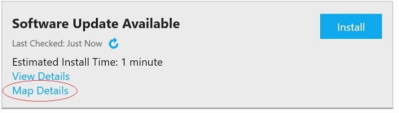

OK.. try this Chris, when your Zumo is connected to express and you click on the picture of your Zumo, do you get this 'option'?
- Udates.jpg (23.51 KiB) Viewed 3020 times

Re: Dusted off the 660.
Hi chaps, only just got back from a day out.
Les, no I don't get Map Details come up. Probably because I don't have lifetime maps and I can no longer buy updates.
