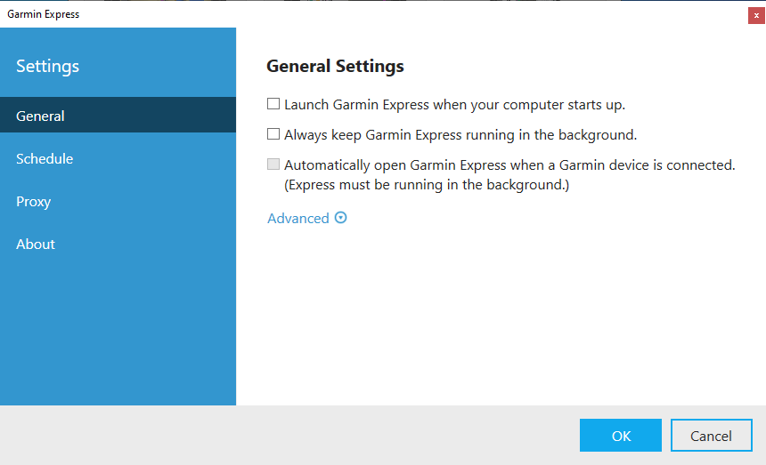

Re: Planned distance not making sense
To make Express not load up on startup:
1. Load Express
2. Click the Gear Icon at the top to get this screen:
3. Untick all of the boxes.
Close down Express.
You used to have to do this every time that Express was updated. I haven't seen that happen for a while - but I use a PC, so if there is an issue in future, just check that Express hasn't been reset to keep running in the background.
1. Load Express
Close down Express.
I jsut checked, these are still unchecked,...
So that should work...
