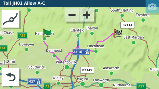

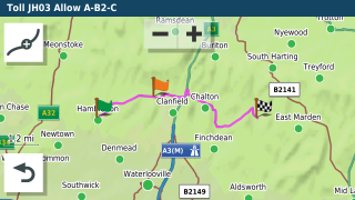

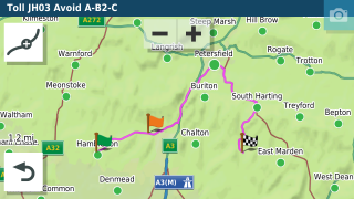

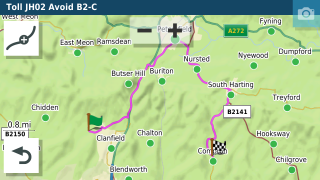

Re: Routing errors (again) - any idea of a point of contact that may care ?
Not quite.
If you set the XT to avoid toll roads, A-C works. The other two tests take a sweep north to Petersfield
If you set the XT to allow toll roads, A-C takes a sweep SE first, then NE. The other two work.
Avoid Tolls Set
Toll JH01a Avoid A-C .png (77.41 KiB) Viewed 2235 times
Toll JH02a Avoid B2-C.png (90.46 KiB) Viewed 2235 times
Toll JH03a Avoid A-B2-C.png (80.84 KiB) Viewed 2235 times
Allow Tolls Set
Toll JH01a Allow A-C.png (79.23 KiB) Viewed 2235 times
Toll JH03a Allow A-B2-C.png (77.62 KiB) Viewed 2235 times
Im sure the tolls thing is a red herring. I'm wondering about the affect of the presence of B2 in the route. But so far, I cannot see a clear pattern
