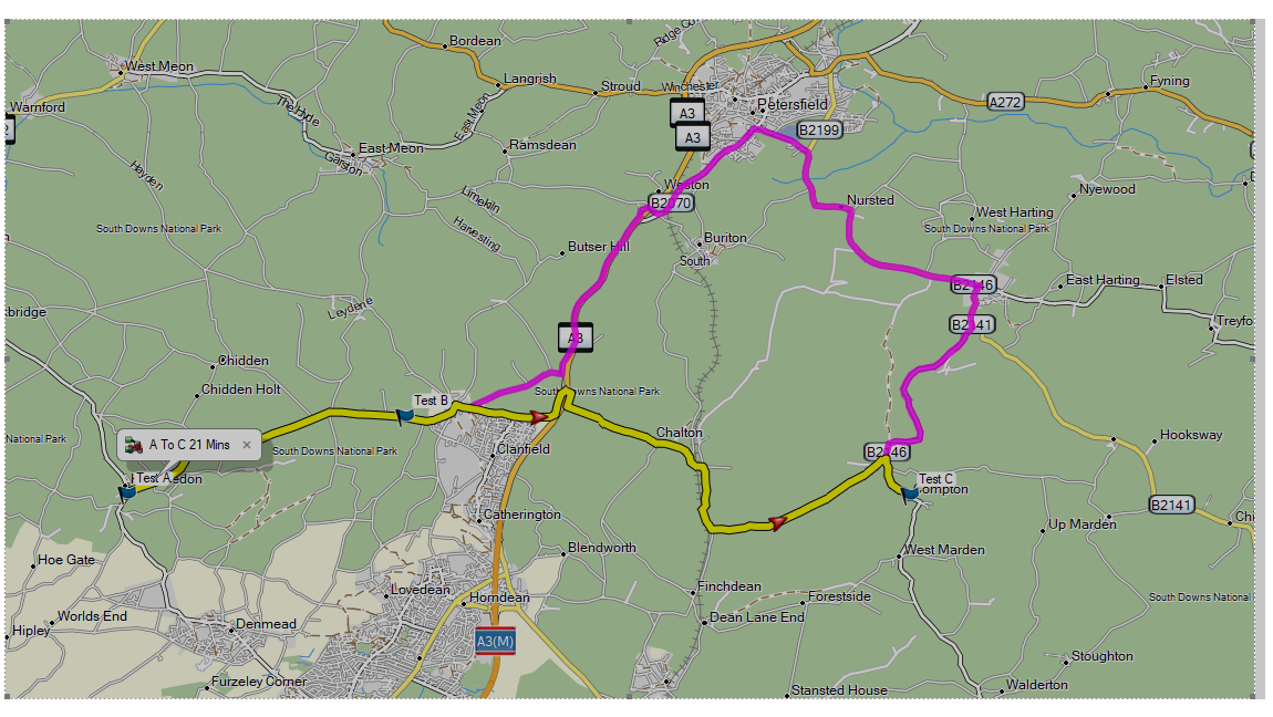

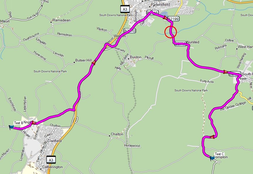

Here is the message I sent to Garmin, I have attached the image ( cant figure out how to insert inline) and the GPX file so you can try this, I am using the updated Garmin Map, I do not think its a map error because the when I calculate A to C it works correctly
I am trying to figure out why in loads of occasions the my Garmin XT routes me through town centres, and routes that seem very odd, and is very annoying.
I have setup some tests, I have 3 way points , A,B and C . All these tests are done with no adventurous routing, and no avoidances and routing option set to the fastest time.
Tests (See image below for visual representation)
1. When I create a route from A to C it creates a route as expected. This route takes 21 mins (Yellow route below)
2. When I add a way point B that is on the route, the route changes to go north through Petersfield and the route takes 28 mins (Magenta Route )
3. When I create the route from B to C it follows the route in test 2.
I have attached all the data you need to test this. Please could you help me figure out why ?
https://photos.app.goo.gl/Bz2ZHy3doxwknHiE7

Re: Routing errors (again) - any idea of a point of contact that may care ?
Just tried that and in BaseCamp it doesn't route via Petersfield. If it's doing it on your device that's very strange.
I've also downloaded your gpx file, if I force a recalculate then it follows the route I'd expect and doesn't go via Petersfield

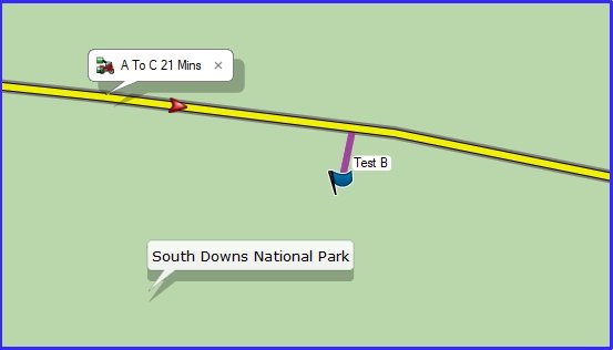

Ok - back home now and have access to Basecamp.
Scott has 3 routes A to C, B to C and A to C Via B.
Only the A to C takes the shortest, fastest route. The other two, both of which involve Point B, take a large loop to the North.
Use Basecamp to Zoom in on Point B to reveal the issue.
Point B is not located on a road. Move point B onto the road and the problem goes away. So does recalculating the route.
So how can it happen that Basecamp will calculate the route in one way and then calculate a different way without anything having changed. The only time I have ever come across anything like this is on Alpine Passes when I was spending winter preparing the route and then came back to it before leaving. Basecamp would not route me over the pass in winter. Seasonal Road Closures.
But that cannot be the case here. Here is a possible explantion - only a possibility, I cannot know for certain.
Route between two points is created.
An additional point is dropped in error, or the wrong tool has been selected.
Whatever, an additional unwanted shaping point is now controlling the route
The offending shaping point is deleted - except this is not the way to do it. This removes the saping point, but leaves the route intact.
See- No shaping point. But the route remains as it was.
Which is exactly like the route that was provided. As soon as the route is recalculated it returns to the expected route.
But there were two routes that had this problem, so either the same mistake was made twice - once for each route , or a third route was created from the one that already had the problem.
The correct way of deleting a point is to remove it from the route list. Selecting Remove Shaping Points removes shaping points but leaves the route where it is. The method above is not a programming error - it is deliberately designed by Garmin to get rid of unwanted shaping points without affecting the route. The route is still transferred correctly to the Zumo, and the Zumo will follow it. Until it recalculates !
It is very useful for finding out which sections of a route are recalculated in different situations when riding. I use it for testing purposes.
