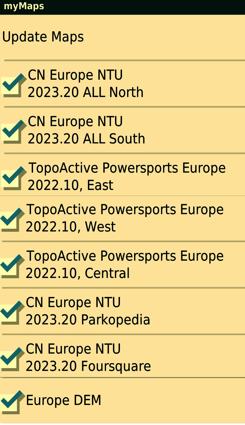

sussamb wrote: Tue Feb 28, 2023 6:57 am Do you keep all maps selected then? If they overlap this isn't a good idea and can cause numerous issues. Perhaps you've found the cause of your problem.
On my side I only have the City Navigator Europe NTU maps ( North + South) enabled + the other stuff shipping standard with the ZÜmo. The "other stuff" I understand (from you actually) is non-routable material and should not be a problem. That being said ;) I have also tried with only the CN Europe NTU North and South maps enabled. Same result (calculating)
maps enabled.jpg (257.01 KiB) Viewed 3336 times
