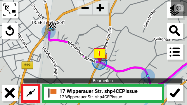

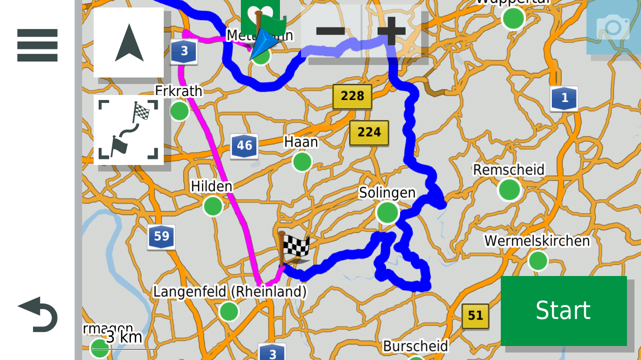

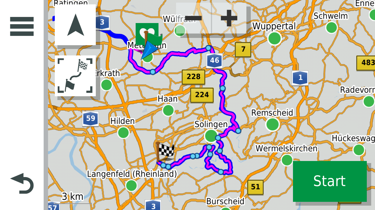

Couldn't resist testing this. Here is what I did:
Imported the GPX in BC. Kept only the route: CEP Tst RatSol BCshp Nok
Duplicated that route as 'Fixed'. Moved/deleted all shaping point placed at junctions, or requiring a Turn. Basically the shaping points that were already identified as problematic.
Created Waypoint 'Mettmann' to serve as point where to start the CEP from.
Attached the GPX in the zip.
Transfered Trips,Tracks and Waypoints to my XT (!) using TripManager.
Using the GPS simulator set my location to Mettmann
Started both routes with CEP.

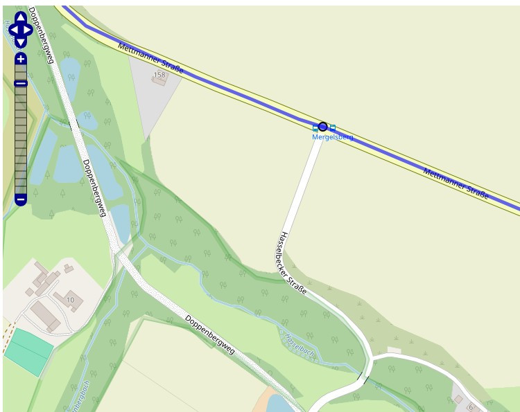

Nok was indeed NOK Fixed was indeed fixed My conclusion is that CEP does not like shaping points that require a u-turn, nor does it like shaping points on junction. Let me share my theory on that.
A junction (or crossing) is a point where the gps coordinates are the same, but the road Id's can be different. If the Zumo, after recalculating, thinks that the road crossed is meant, it would require also a u-turn.
In the attached example 'Humans' mean 'Mettmanner strasse', the Zumo might think you mean 'Hasselbecker Strasse'.
Now I fully understand that my results may not apply to the XT2, and that on the XT2 other parameters come in to play.
But to me, with my XT, this is just a variation of viewtopic.php?p=5801&hilit=glitch#p5801
I do agree:
- 'mImported' is not related.
- Recalculation can play a role, especially if the recalculating changed (slightly) the coordinates of routepoints. As was observed with Tread and the XT2
Frank

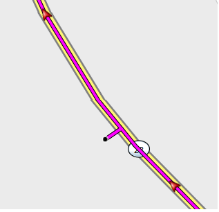

I think @FrankB has nailed it. I found that my problem route did have a shaping point at an intersection and another just off the road. (I think this was due to a map update since the route was created, but it doesn't matter.)
Those points were miles past the section of the route which needed to be recalculated by CEP, so I am surprised they had an effect, but they did. I fixed the points and CEP behaved well for imported, saved and recalculated versions of the route.
Another thumbs up for Frank
Thank you again.
... and another reason to carefully check, and re-check all route points at close zoom level ... and then do it again after a map update.

@proofresistant pointed out that u-turns are a key. Thank goodness for pizza stops
@FrankB helped me understand that a point at an intersection can look like a u-turn to the XT2.
I suspect a point misplaced just off the road might also be a u-turn.
The important thing is that we now know what's going on and how to avoid the issue.
