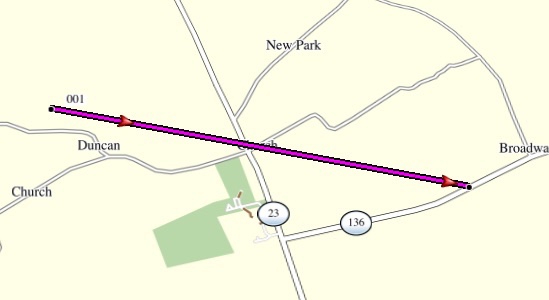

Trying to learn to use the Zumo 660LM I just got from my friend. When I use the creation tool, click on a start point and drag the icon across a road or two with curves, I only get a straight line displaying. Using base camp. My old nuvi 755 displays a route properly following the curvature of the roads. My friend said he never had this issue so couldn't really help me. I hope to use it once or twice before I kick the freaking bucket. :roll:
Straight line route display.jpg (35.52 KiB) Viewed 6302 times
Have updated the map to latest City Navigator North America NT 2021.3.
Any tips would be greatly appreciated by this old,non-tech geezer.

Check the routing options in Basecamp as something is amiss with it
Re: Route only displays as straight line
Looks like you have direct activity selected. If you're new to BaseCamp work through this tutorial
Make sure you are using the same map set in Base Camp and on the device.
Well while that's true it's not the cause of this straight line ;)

And when I downloaded the Base Camp (yet again but this time from the instructions in the tutorial), the routing ran perfectly.As I went from click to click the magenta route line sinuously followed the actual road contours like an impassioned pit viper. Wow how cool is that? I don't even remember what I did.

The straight line issue is possibly due to having a vehicle other than motorcycle or car selected. eg walking / off road.
Alternatively your preferences for the route are set to off road, rather than faster tine ir shorter distance.
Note that Basecamp has features which were introduced after the 660. Garmin state that under certain circumstances, the 660 will have problems with routing when a route has been created in Basecamp. It suggests using Mapsource instead.

Well so much of this flies over my poor aging brain but the fact that whatever happened when I used the Garmin site to download the Base Camp program again worked makes me happy if ignorant. Now that I can get the route indication flowing on roads and not doing the flying crow imitation, I need to move on to how to save a route once I create one and then insert it into the Zumo itself. When I was trying to do this with my nuvi 755, it would never work.

"The straight line issue is possibly due to having a vehicle other than motorcycle or car selected. eg walking / off road."
Oh thanks jfheath, forgot to address this. I had MOTORCYCLE selected as the vehicle of choice, so that issue wasn't the cause. Somehow when I re-downloaded the BaseCamp program from the Garmin site, this time it coordinated the newer maps in the 660 and my computer. Well like I say, over my head.
