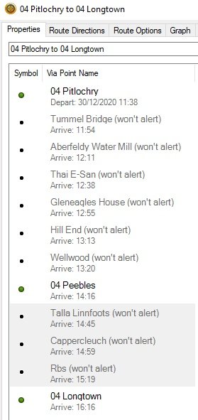

Re: Basecamp devise transfer options.
Yes, and vice versa.tcbandituk wrote: Wed Dec 30, 2020 9:53 am So if you change a Shaping point to Alert on Arrival, does it then become a Via point?
It is a tad confusing because the route list in Basecamp that lists all of the points has the heading 'Via Point Name' - even though it lists Non Alerting (shaping) Points as well as Via Points - as shown below.
I think that it is a remnant of the software when the Zumos only handled Via Points. (eg 550).
You can also change them on the Zumo itself: But there is a glitch on the XT and the 595: If you change a Via Point to a Shaping Point on the Zumo screen, it will probably change its name and move it to a different location !! It doesn't happen changing a shaping to a Via Point, and it doesn't happen at all on the 590.
(Fault reported to Garmin and acknowledged).
