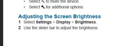

Re: Power outage and screen brightness
Screen issue is probably connected to the power issue, as all Garmins unless they've been set to be the same have different brightness settings depending on whether running off external power or battery.
sussamb wrote: Sat May 15, 2021 6:15 pm Screen issue is probably connected to the power issue, as all Garmins unless they've been set to be the same have different brightness settings depending on whether running off external power or battery.
This is possible??
Yes
sussamb wrote: Sun May 16, 2021 7:19 pmYes
Care to elaborate? Web search shows no mention and my manual says nothing about it.
And in several places
Just try it and you'll see. Maybe the XT doesn't but all other Garmins I've used do. See here
https://support.garmin.com/en-GB/?faq=W ... oZBV7oLJn5
