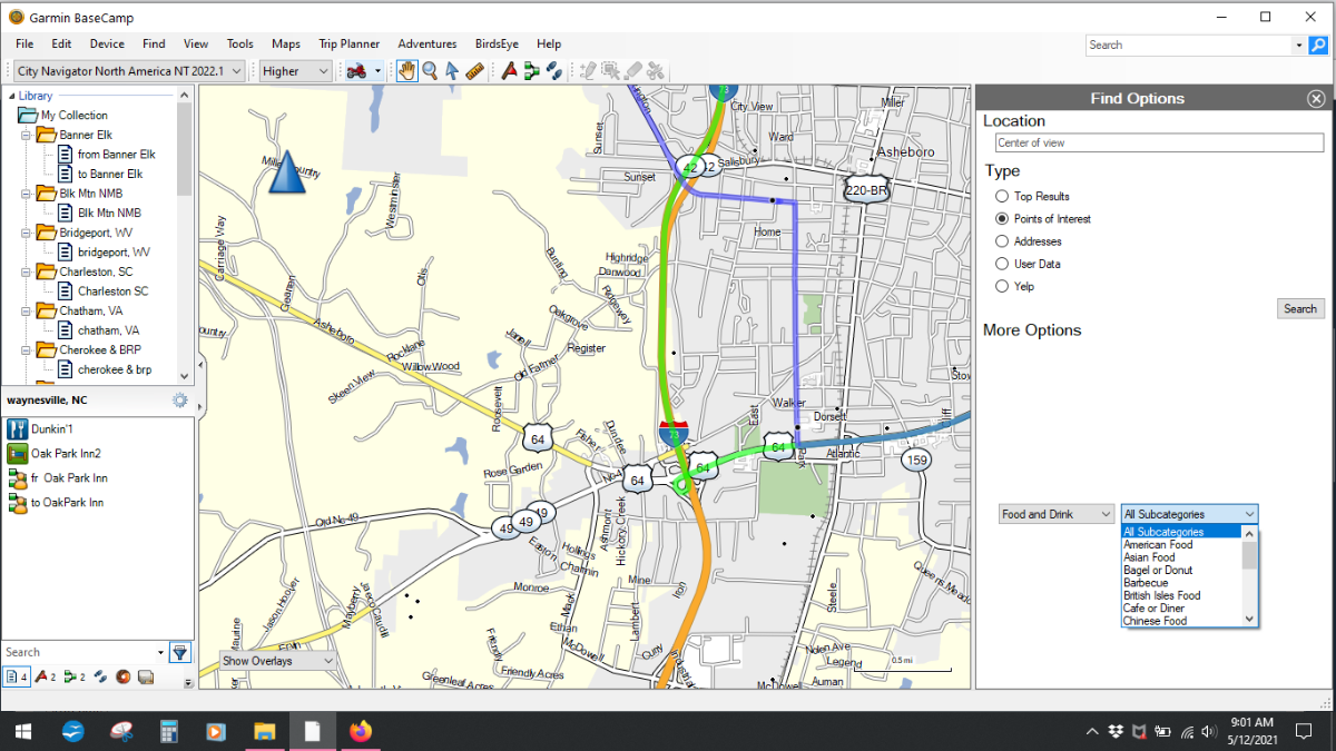

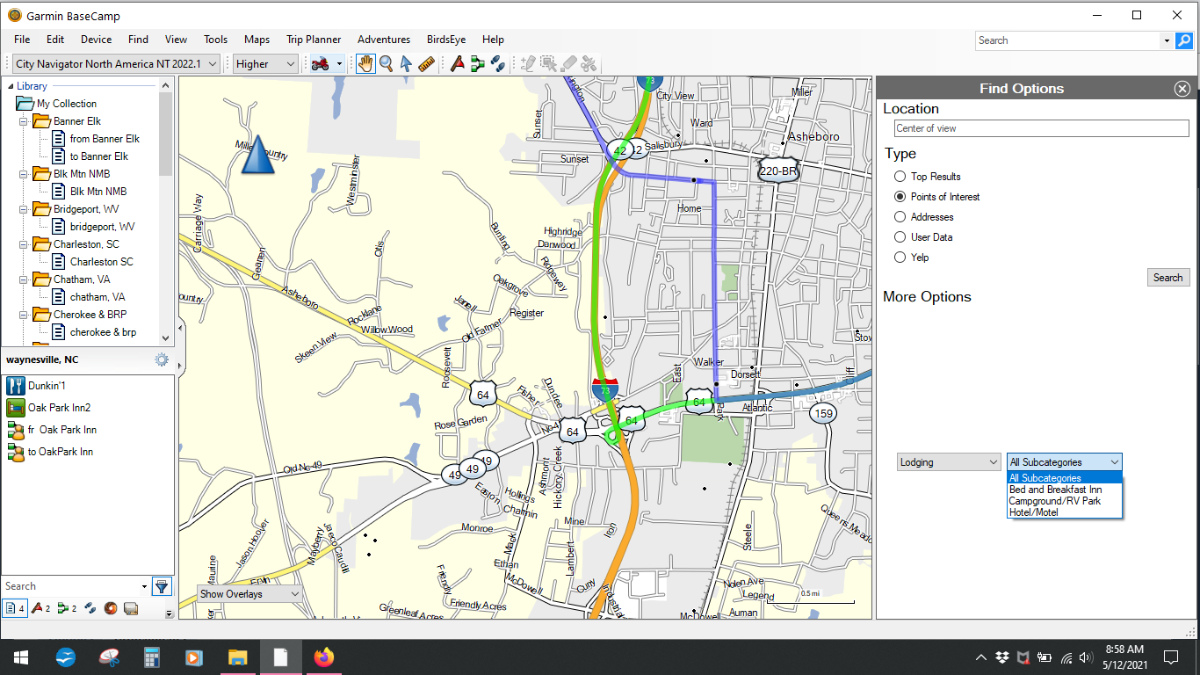

What I see with Base Camp 4.7.3 on a Win10 laptop and no gps connected:
Screenshot (6).png (492.99 KiB) Viewed 5929 times
and
Screenshot (7).png (497.06 KiB) Viewed 5929 times
Wonder what changed in yours.

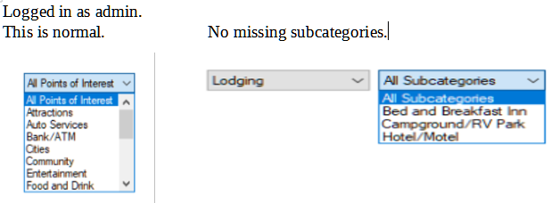

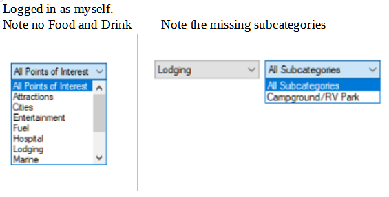

Here are some screen snips of what I am seeing when logged in as myself vs. as admin. Same map is selected in each although map selections doesn't make a difference. Behavior is the same regardless of the map. The device is not connected.
BC POI as myself.PNG (49.18 KiB) Viewed 5693 times
BC POI as admin.PNG (54.81 KiB) Viewed 5693 times
