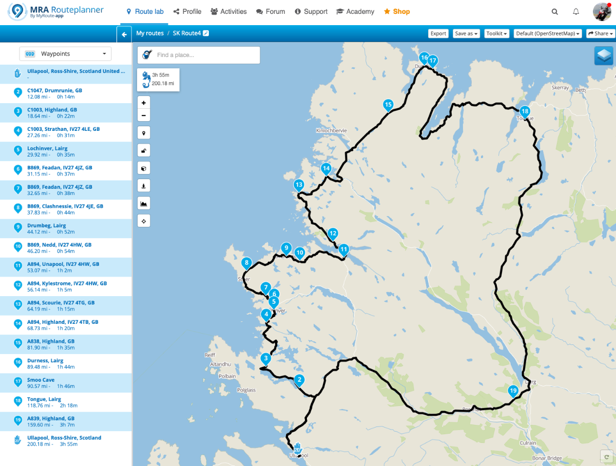

I'm not sure on the difference in naming. MRA seems to call it a Via point (which appears to act the same way as a waypoint to me).
If you look at the following route you can see my Via points on the map and listed When you zoom in, click on a point and then click the three dots for more options (an ellipsis) then you can change the via point to a stopping point (hand shape), but I'm not really clear what the difference is?
I then go to my phone and use the MRA App to find the route I want, export the gpx 1 file and then send that to the Garmin Drive App, I don't go near Basecamp anymore as it just seems to screw things up.
The alternative is to export the gpx 1 file on your computer, email it to yourself and then on your phone try export it to the Garmin Drive App (but this seems an unnecessary extra step)

Re: 12 days on the road with MyRoute-App and Zumo XT
In MRA
A waypoint is used to describe any point on a route.
A Via Point is a Stopping point (or a Hard waypoint).
A Shaping Point is a shaping point (or soft waypoint)
A POI is a saved location - which can be placed on a map.
I don't believe that a POI can be included as a point in a route. Or if it can, I would like to know how.
In Basecamp
A waypoint is a saved location (similar to a POI).
In Bascamp a Waypoint can be put into a route and it becomes a Via Point, or a shaping point. You can change it easily - just like you can on MRA.
A Via Point on a Zumo is referred to as a Destination. It shows up as a flag. It is listed in the Select Next Destination display when starting a route. It can be displayed in the trip data - shwoing ETA and distance to Via. I use them for stopping places. You cannot ignor a VIa point when navigating without having to press the SKip button to tell the XT to ignore it.
You can ignore a shaping point. The XT doesn't like it and will try to get you to go back to it - but as soon as you join the magenta line after a missed shaping point, it will continue navigating ahead and forget about the fact that you haven't visited it.
Whether you use Basecamp or not, you will find this link useful

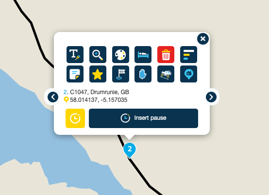

MRA is a tad confusing with its tear drop shaping point and its Hand stopping point.
When you click on a tear drop shaping point on your route, it shows the menu with a tear drop and when you hover over it, it says Via. I think this means that if you click it, it will change it to a Via (a hand)
If you are not clear about the differences between Vias and Shaping Points, this is more than likely why you think Basecamp is screwing up your routes !
In particular - you say you are using gpx v1 to export from MRA. That just sends Via Points tot he Zumo (flags on the XT screen). Any that you created as shaping points are also sent as Via Points.
I use Vias for the 3 or 4 stops, plus the start and the end. I use Shaping points for the rest of the route. (Actaully I put my Vias on the road that I want to take after the stop for coffee, and mark the cafe with a shaping point. It makes it easy to ignore the coffee stop if I don't need one).
For a long time, MRA would produce routes with only shaping points, or routes with only Via Points. They have just recently brought out their 1.2 gpx which addresses the particular needs of the Zumos.
Its a pity that they haven't got their POIs sorted out so that they can be integrated in the route.
This comment will be out of date before long - cos I have just told MRA about it - but if you try to access your MRA v1.2 route using BAsecamp, Basecamp fails - whether you read it from the Zumo or by sending it as GPX file. It didn't do it with the beta version though.

Dont forget in MRA -
Teardrop = shaping point
Hand = Via Point.
