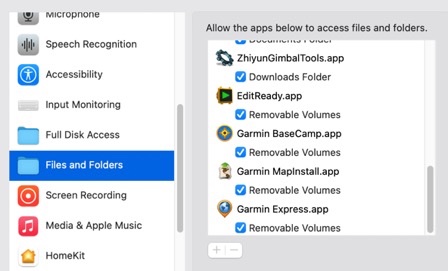

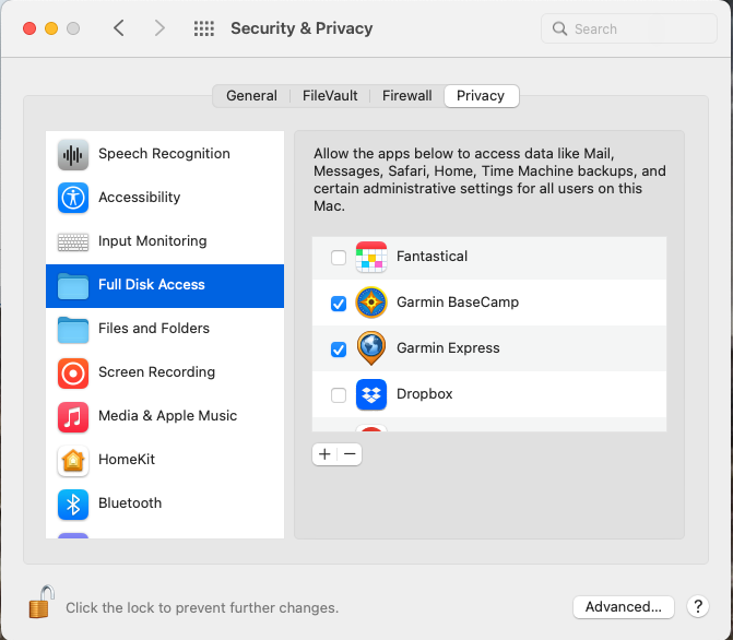

Since it doesn't show as a volume, I checked my Security & Privacy Settings in System Preferences and all items for Garmin we're checked (see below). In addition, I re-downloaded Garmin Express. During the installation steps under License it showed a 403 Forbidden error for English (see below). Never saw that before. English is my choice of language.

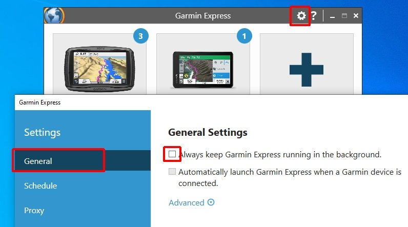

Make sure that Express is not running - even in the background. Make sure - load it up and select the option not to run in the background when it is closed down. This is in the gear menu on a Pc.

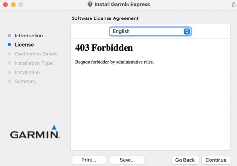

For Express, just click on continue and it install further. Works perfect after that.

Thank you Vespamarc for your help. I did select save and continued with the installation process for Express. It installed without any problems but, still doesn't recognize my Zumo 595LM. In regards to USB A, I've been using the oem Garmin data cable along with many other same type data transfer cables without any issues by using a USB A female to USB-C male patch cable since 2016 on my previous MacBook Pro. Now, with this new MacBok Pro M1 Max it's not being recognized. I've tried several different cables but, the issue remains. Other users are having the same issue (link below). Thanks agains again, I sincerely appreciate your help. Ray

I don't know about the Mac version, but on the PC Version it is set from the gear icon. Click the Pic for a better image.PaulaRay wrote: Mon Mar 21, 2022 9:59 am In regards to Express, I made sure it wasn't open. Other than that, I'm not sure how I would go about making sure it's not running in the background for some reason.
Every time a new version of Express comes out, it puts the tick back again, I have to remember to not allow it to run in the background.

Sorry for the delay..... Thank you for your help. I found it running in my upper Mac tab and un-checked it. I tried to connect the Garmin in both situations checked / un-checked but, no luck. I just did another Garmin Express update version 7.12.3.0 which didn't resolve my problem as well. Thanks again, appreciate the help.jfheath wrote: Mon Mar 21, 2022 7:38 pmI don't know about the Mac version, but on the PC Version it is set from the gear icon. Click the Pic for a better image.PaulaRay wrote: Mon Mar 21, 2022 9:59 am In regards to Express, I made sure it wasn't open. Other than that, I'm not sure how I would go about making sure it's not running in the background for some reason.

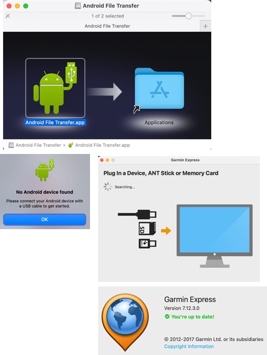

Re: Zumo 595LM Not Recognized MacBook Pro M1 Max?
Sorry for the delay..... Thank you for your help. I tried it, but it didn't recognize the Zumo as shown in the pic's below. I also did another Garmin Express update 7.12.3.0 No Luck........... Thanks again for your help.Bluenoser2 wrote: Wed Apr 06, 2022 5:29 pm Hi There:

Does Garmin Express and BC have "Full Disk Access"? See screenshot. Was your Zumo on or off when you connected it?![Image]()
