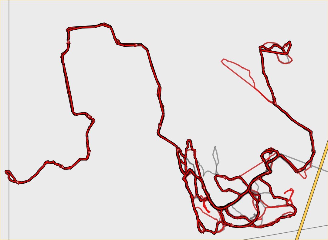

Perhaps I am explaining this wrong. I just want to turn this track into a semi-transparent layer that can be pasted over an aerial photo of the area that can be used as birds eye images in the gps. It needs some editing and I guess it would be nice if it could be something the gps recognizes as roads but i'd just be happy with a marked up map.
Edit: The area this track encompasses is about a hundred acres not counting that long tail on the left.
- Timmyland trails.jpg (86.06 KiB) Viewed 2061 times

Re: Converting a track to a map
Is it possible to edit it first? I have to get rid of some lines I accidentally created like the two straight grey lines on the right. I forgot to shut off the tracking then turned the unit on at home so it made a beeline right to the house. Not sure what the other one is pointing to but I'd like to get rid of those and a few other similar oopses.sussamb wrote: Thu Apr 14, 2022 5:20 am If they exist as gpx tracks or routes then the program I mentioned above will create a transparent map for you.
Yes, of course - take any program you like (e.g. Basecamp) and manipulate the track as you like - save or export it as .GPX file and use it with the program sussamb mentioned to create a transparent map...
