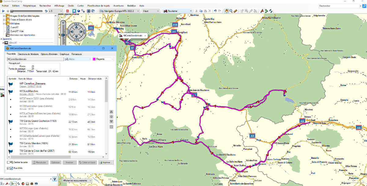

Hello,
I use BC to create the routes and tracks.
Maps and settings are identical on BC and ZumoXT.
I systematically recalculate the routes on the ZumoXT after exporting to SD card from BC.
Below is an itinerary in the Alps

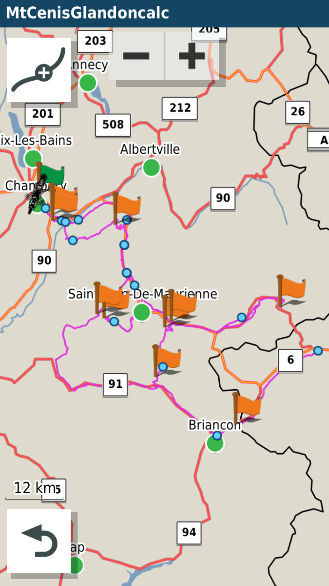

after recalculate on the XT
On the route recalculated by the XT, impossible to reach the Col du Glandon at the Col de la Croix de Fer and impossible to go through the Col du Mt Cenis.
The length of the route increases from 440Km to 717Km

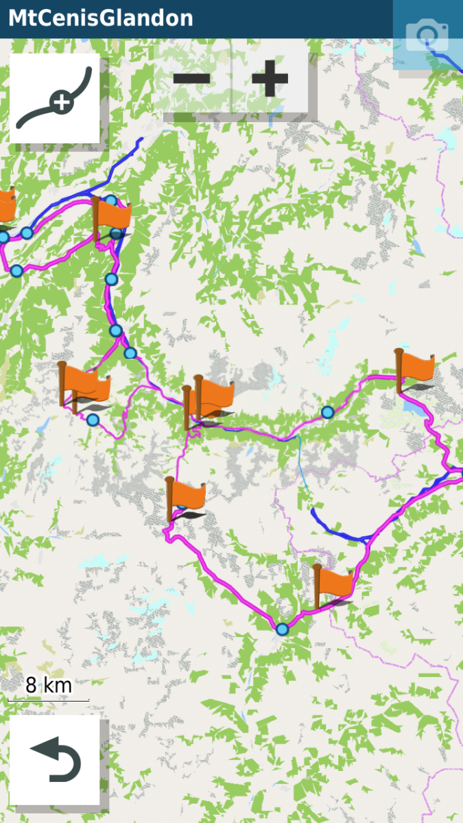

below the images on the XT

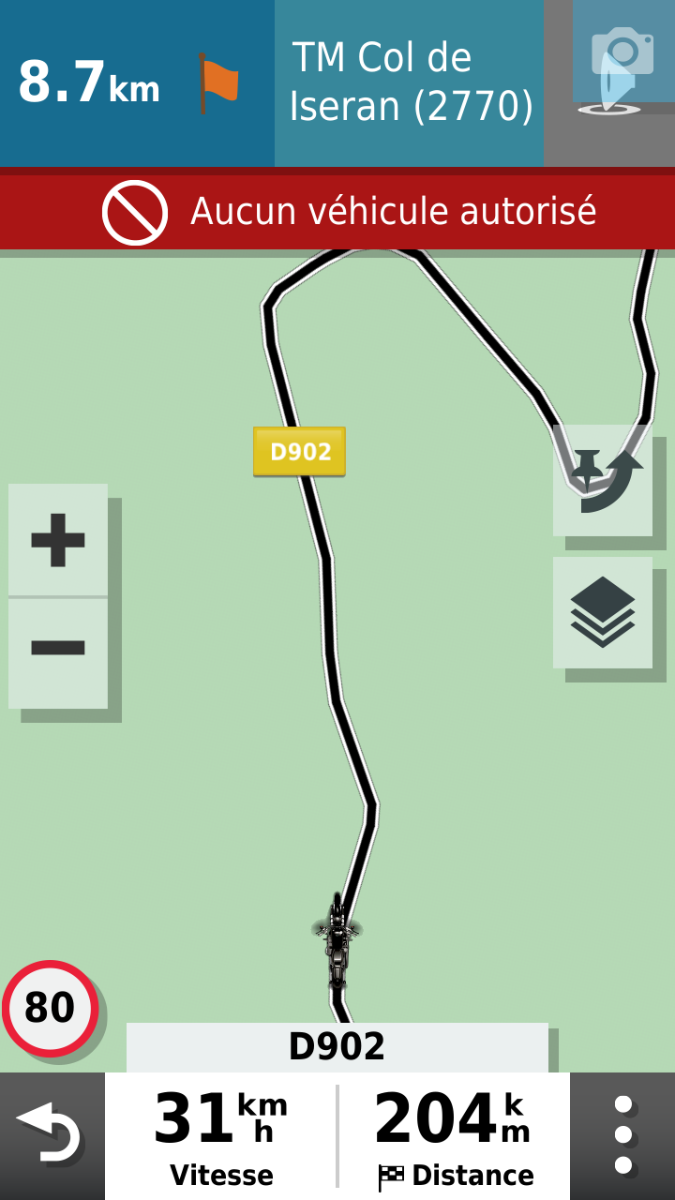

On October 26, 21, I had the following message on my XT while climbing the Col de l'Iseran. The pass will be closed the following month.

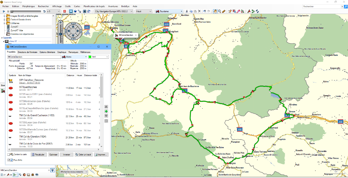

I see the problem.
I think the route has not been recalculated after being loaded into Basecamp or into the XT, and I think that some shaping points may have been stripped out of the route on transfer. There don't need to be that many Via points - but it needs extra shaping points - which were probably there in the original route in Basecamp - but these have now gone.
I've attached a slightly modified route using the same points, but which still needs some attention.
All of this is described below.
At some point, I think that you have had the setting in Basecamp to avoid seasonal closures - but I cannot make my Basecamp miss out the cols that the route clearly does miss out. But when I recalculate the route those problems disappear.
When Basecamp receives a route, it accepts the exact route that it was given. It doesn't recalculate it. So when I opened up your route, it showed my that it would not go over the top at Croix de Fer, nor would it go past the lake at Mont Cenis. But as soon as I recalculate the route, it will gover over the cols. It behaves more like the route that you got by using the OSM maps.
I note that there are some missing Shaping Points in this route. - The Reason being that some points are visited for no reason using the same road to reach it and to travel away from it. The original route must have taken a different road to reach it. I am wondering if they have been deleted on Transfer by Basecamp, or whether this was the intention.
