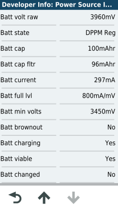

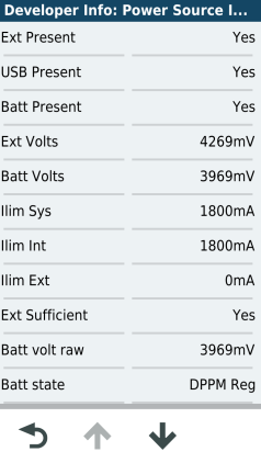

There are a couple of options for displaying battery and mount status. One is in the Developer Info - accessed by the hidden menu - long press the circular speed button. Two screen shots attached.
The other is obtained by long pressing the battery icon in the top right hand corner of the main screen. When in the mount, mine shows it is int he motorcycle mount and the mount voltage is 3.20 volts. Battery voltage is around 4 volts.

I would make sure that the battery is fully charged. Check the two diagnostic screens for the battery. The screen obtained by pressing the battery icon shows a battery state with a number. Mine shows 97. I guess that is a percentage.
