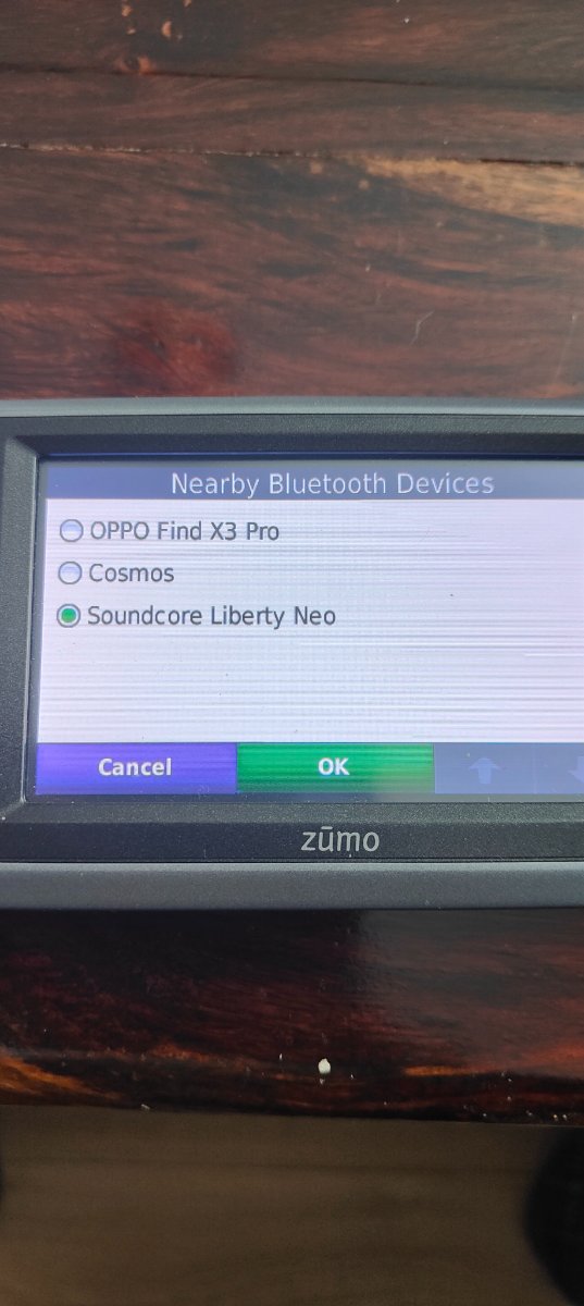

Re: Pairing
This is what comes up on the screen
- IMG20220526125434.jpg (225.08 KiB) Viewed 7694 times
- IMG20220526125443.jpg (225.35 KiB) Viewed 7694 times

Re: Pairing
From your photo, it looks to me like you are trying to pair the earbuds as a "Phone" using the "Add" function. Won't work. Have you tried using "Change" in the "Audio" BT pairing menu?
