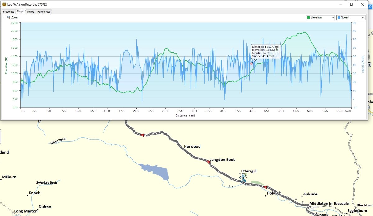

I experimented with the Recorder a couple of times last week. I normally just use the track logs, which are recorded all of the time, so I have just done a quick analysis. On a 56 mile trip, it recorded roughly 2000 points. Of these, 1081 points were recorded within 1 second of the previous point. 1725 were recorded within 5 seconds of the previous point. The largest gap between one point and the next was 12 seconds. You can load the track into Basecamp, and this will show each of the points that were recorded. See the image below. Note that you can also inspect the track and display graphs of the speed, elevation and link this to where you were on the map. Click for a larger view:
Track Points.jpg (98.93 KiB) Viewed 1889 times
It is easy to see that the interval isn't fixed. There are many more points recorded where the road bends, and the big gaps appear on the straight sections. Of course, this is where I am travelling, slower, or faster respectively. I don't know how it would behave going at slower speeds off road.
