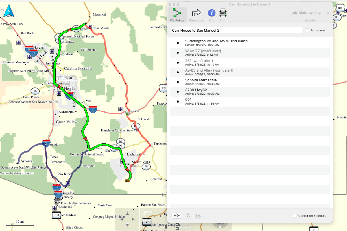

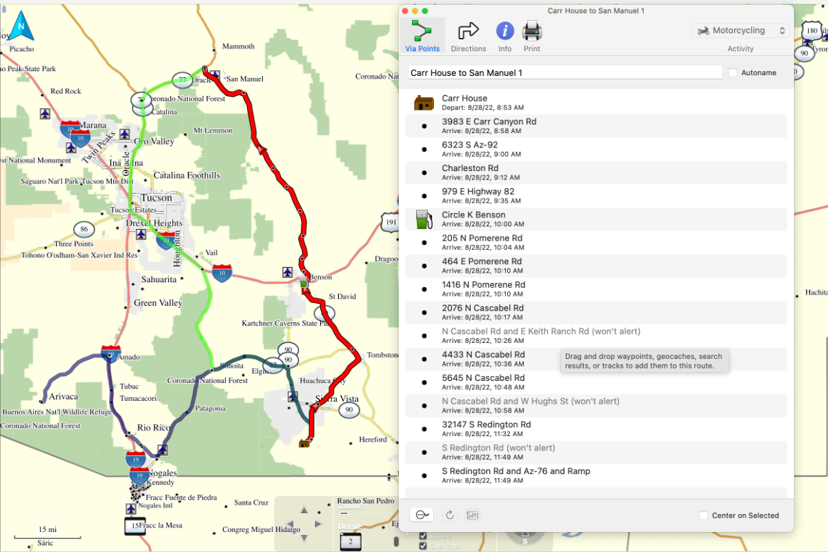

Thanks for the link but not much help. These are dead simple routes very few points. In fact the route that fails only has a handful of point. The route in Green is the route that failed to import, the other worked fine, plus it had more complex road types. Hwys to dirt. Failed route all paved roads and interstates.
The failed route was basically calculated by Basecamp.

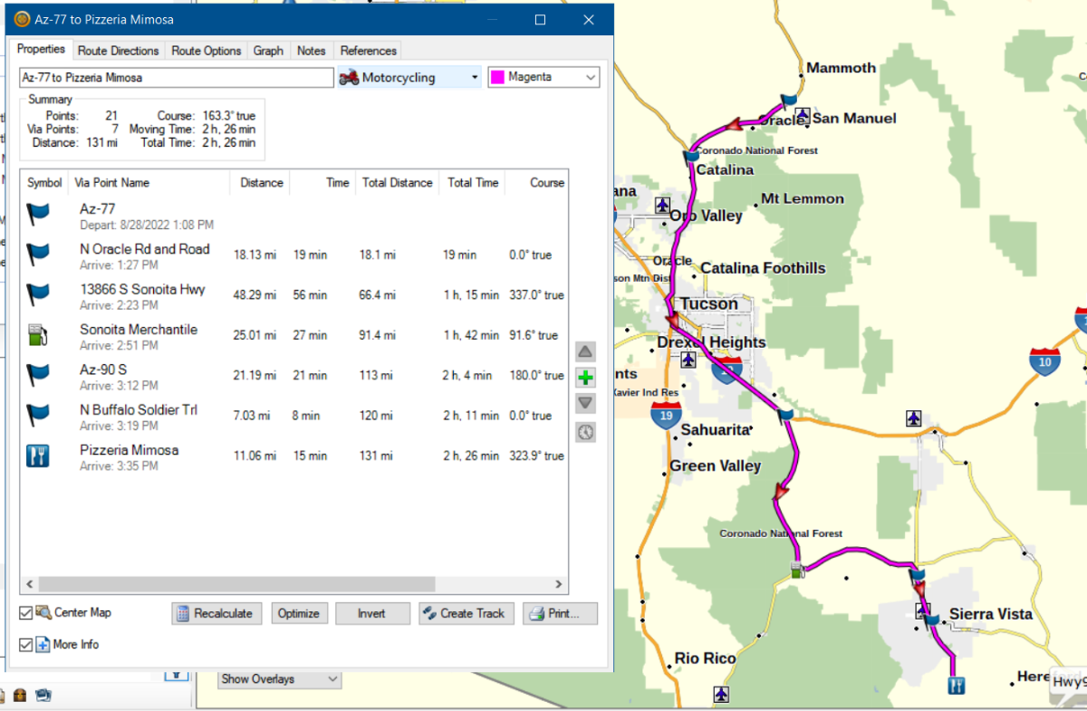

This one calculated for me (wish I could make the XT think I was somewhere else so it wouldn't calculate from NC). I know that I don't have the same points as you but I think they are in the ballpark. I don't have a clue why yours doesn't calculated. The only thing I can suggest is try using different points.
Edit: I don't know if it's relevant but I'm using map CN NA NT 2023.2 in BC and on the XT.
- BC AZ-77 to Pizzeria Mimosa.png (443.94 KiB) Viewed 3780 times

That one fails with "Cannot Calculate the Route". This one works though. I loaded yours into BC and made 3 minor point changes. I don't know which one of them it didn't like nor can I explain why one works and one doesn't.

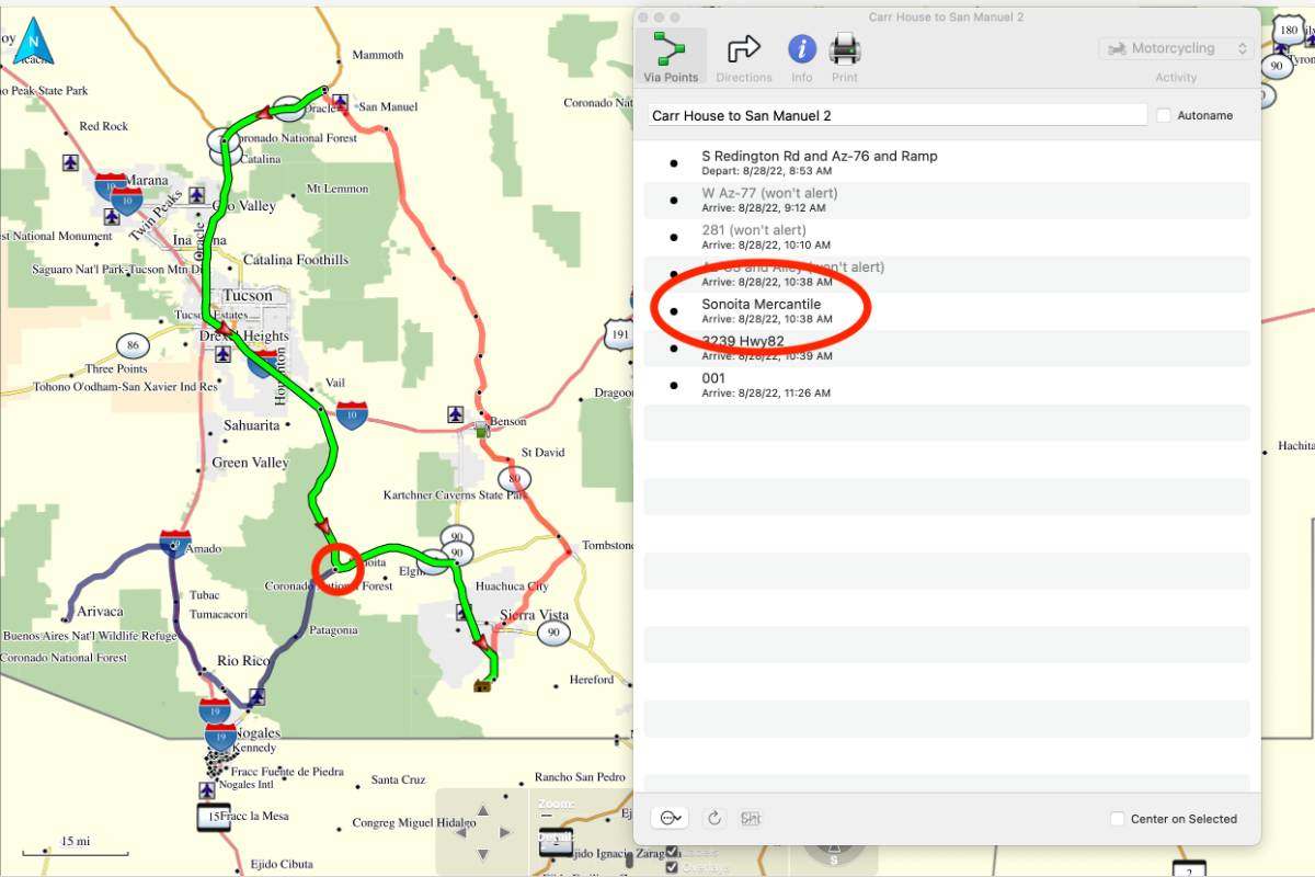

Re: Zumo XT "Cannot Calculate the Route"
Peabody, thanks for all of your responses. Although your last response about the XT behavior and no real resolutions is bothersome. These are expensive units and Garmin should provide at a minimum an error log when building imported routes.
But for me I did find the issue, see attached, the two circled items. It was a stop point, basically an in and out, coffee break etc. I split the original route in Basecamp into three and narrowed it down to the circled area. Joined all back together for the original loop and the route did build and looks correct. But since I have not used the build to actually navigate the route I really don't know if it will work. It should, but like the 660 there were times that things didn't go according to plan.
