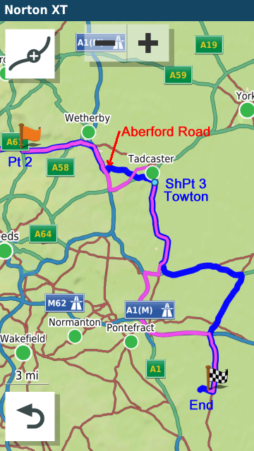

Example of Unexplained behaviour on the XT.
The first image shows the route that I plotted in magenta. Underlying thatit the track of the route the roads that I followed in dark blue. The route started about 20 miles to the right. The first Via Point flag is shown on the screen shot. (Near Harewood if you know the area). The seconf route point is a Shaping point. This is placed just south of Tadcaster at a village called Towton.
Although I deviated from the original route, I passed through both route points. After Towton, the satnav was happy to route me ahead, but it wanted to take me onto the A1. This part of the A1 is a two lane motorway and is invaribaly brought to a standstill when one lorry doing 59.1 mph tries to overtak another doing 59mph. I prefer to avoid it, so I head East onto the A19 heading south as shown by the blue track.
For the rest of the journey, the satnav is trying to take me back to the motorway. Before running this route, I checked on the XT how it would navigate me towards my destination starting from different places along the blue track. IN the middle of that track is a village called Hambleton. If I place my start point at the East end of that village, the XT will navigate me East and then South to the end point. If I place at the West end, it will head west to the A1 until can turn East direct to the end point.
I expected the satnav to re-route me in the direction that I was heading after I had passed through Hambleton. It didn't. It kept trying to get me to go back. I stopped and checked whether it thought that I had missed Towton. Towton was still in the skip list (oddly), but the Via point wasn't marked on the map any more, and the route made no attempt to visit it.
The second screen shot shows me two miles from my destination. I am the green flag. Destination is the chequered flag.
The route is still heading me back up north, back through Hambleton and then down the A1. Along the original route.
Stupid.

Right - I have a bit more information about the above little problem. It may well be a lightbulb moment.
Please refer to the images in the post above - the screenshots from the route.
The route is a 4 point route. The start is well over to the west.
The orange flag is the Via Point at Harewood.
The blue disc Shaping Point is just south of Tadcaster at a place called Towton.
The destination is south down the A19 at a place called Norton.
Navigation up to Harewood was fine - even though I took a couple of small diversions, the satnav recalculated a reoute and resumed farily quickly. These were just layby type diversions. Leave the road, join it again a little further on.
All is good so far. I went throgh the Via Point at Harewood with no issues.
The satnav was intent on taking me down the A1(M). That is the magenta route heading south. I didn't go down the A1(M), the old A1 runs close and parallel to it and I went down that. So the blue track is not on the motorway, it is on the parallel road. Te blue line is my track - where I actually drove. Part way down below Wetherby and heading to Tadcaster and the Towton Shaping Point, I turned off my parallel road and headed generally East. And this is where the problem begins.
I know that this is where the problem begins because the road heading away from the motorway is called Aberford Road.
Just remember that.
From that point on, the XT was demanding that I turned round. It was trying to take me back to the motorway, I think. As I got close to the blue disc shaping point 3 at Towton, it seemed to give in and finally navigated me the mile to Townton and continued navigating after that. I was back on the magenta line.
Then I deviated again, becasue the XT was heading me for the A1 - that is where its route was plotted. And from that point on it just kept asking me to turn back. All the way until I was nearly at the turnoff for my end point. I stopped and checked the Edit Route list (this is the double headed arrow that can be displayed on the right hand side of the screen).

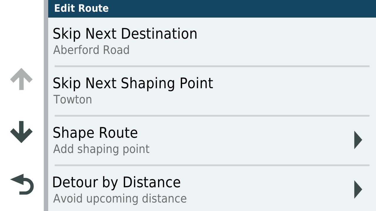

This is what I got:
The next Destination should be the end one - point 4 - Norton
And I passed through Towton, yet it is still there in the list.
But ths significant bit is Aberford Road. Its a destination.. A Via Point. I didn't put it there. The satnav did.
At the point that I deviated from the calculated route following a previous deviation, it must have decided that it needed to bring me back to this point and placed it in the route. I didn't see it happen, but clearly it did. I've labelled this point on the screenshot int he post above with a red arrow and Aberford Road.
Subsequently, I passed through the Towton Shaping Point, but the XT ignored that - it wanted me to get to this new Via Point first. So both points remain in the 'skip list'.
The 27 mile square that the satnav is taking in order to get me back to the end point is finding a way back to Aberford.
It doesn't actually go to Aberford. But I reckon that it realises that this is on the route to the end destination and is happy with that. The XT does seem to be happy to skip a Via point if you get close to the later magenta line.
