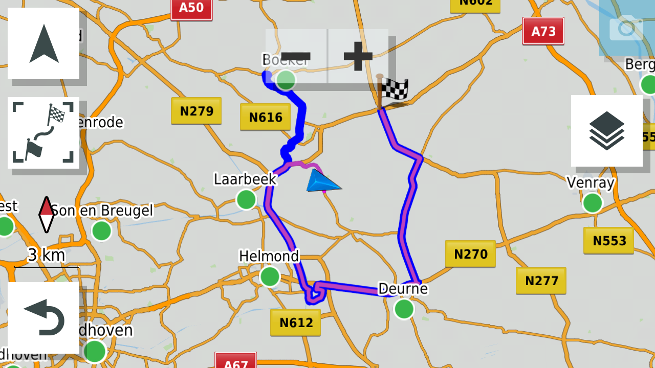

2. Today I tested a 'trip from a track', with recalculation set to auto. It's not something I do normally, but the question was raised, and I did not have the answer.
In short: It makes no difference if the trip was fixed yes or no. The trips behaves the same. Asking for U-Turns, a ghost via point was added and broken tracklogs. The good news is that it's not recalculating straight to the end point when you deviate.

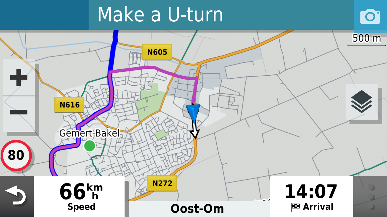

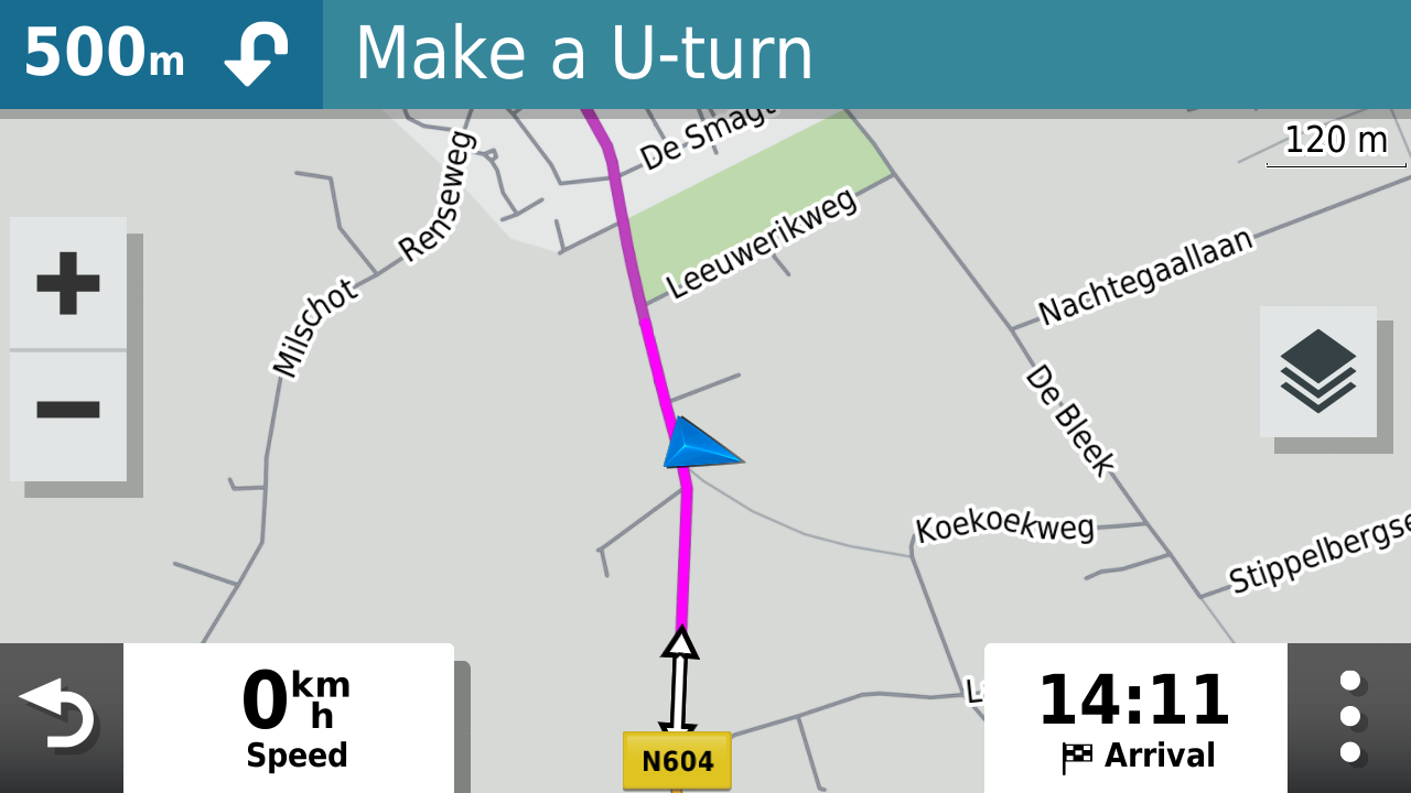

If I would have to describe it I would say: It is trying to get you back to the route as fast as possible. I hope the screenshots will make it clear. (Blue is the original track that the trip is based upon, Magenta is the active trip.Peobody wrote: Wed Jun 07, 2023 1:23 pm What does it do instead, recalc only to next route point then continue with the preplanned route?

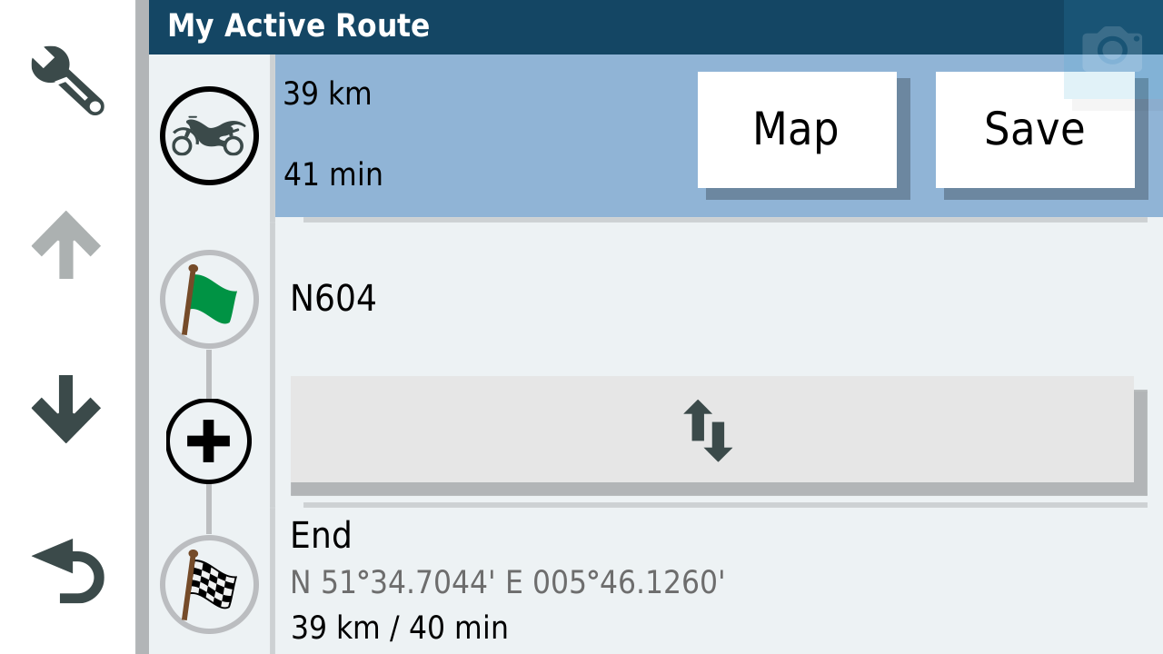

Note: A trip from a track has no route points, only a start and an end point.

And to be clear what I mean with 'A trip from a track'
Open the track in the app tracks. Hit the wrench and then select 'convert to trip'. Next go to the Trip planner and start it from there. You will have instructions.
You can also select Go from the Track app, but then you will have no instructions. And that was not what I tested today.

If you deviate from a track trip in such a way that the closest point is behind you, you will notice something very familiar. A RUT.

I found a very definitive tell tale sign that the navigation is displaying RUT behaviour. Turn off U turns. Deviate and let it calculate a way to take you back by using side roads, laybys, housing estates etc. After it has done a couple of these, stop at the side of the road and look at the route that it is trying to get you to follow. It will contain all of those housing estate / sideroad / layby 'turn round' sections. Why, if it is calculating a new route would it do that?
The answer is that it isn't calculating a new route, it is suprgluing a new section to get you back to the closest point of the original. And that is behind you. And that is exactly what happens when you deviate from a tracktrip. There had to be one key difference that distinguished an XT route from an imported route. So I set about proving that an already tested RUT route would not display RUT behaviour using identical saved Waypoints, If the route was built in the XT.
