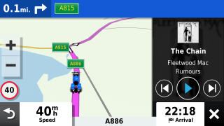

You might also be interested in the widget media player which can be displayed ont he right hand side of the map screen.
Tap the three dots menu in the bottom right of the map, and select Music Player.
It doesn't have a volume control, but it does have a large enough pause/play button.
Although I have music on my XT, and I have the capability - I only listen to music occasionally. I find it too much of a distraction - there's plenty of stuff to concentrate on out there ! Tapping the black are opens up the full size media player at the expense of the map. Tapping the 'X' in that returns to the previous map screen.
