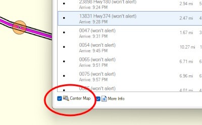

When checking point placement, be sure the "Center Map" box is checked after opening the route. Then, as you click each point in the list, the map will automatically pan and zoom to an appropriate level while highlighting the point, making it quick and easy to verify that the point is on the road.
