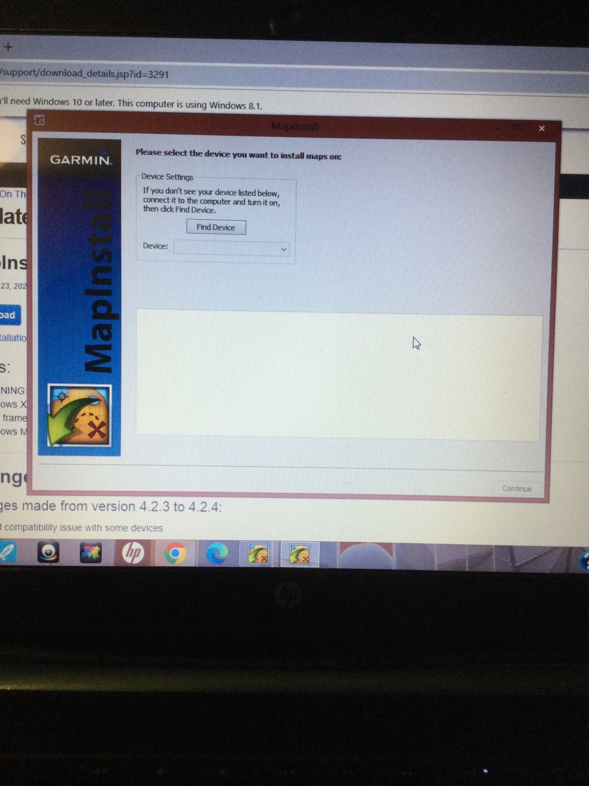

Hi have got as far as down loading map install to my laptop but cannot find the sat nav box with all the leads in it (been tidied up for Christmas) so will have to move forward in the new year.
- 169CFB94-9A3A-4577-823E-DD107F4257D0.jpeg (576.7 KiB) Viewed 5778 times

Happy new year to you and yours,I have managed to down load the maps to my pc only and using map install with the 660 connected it tells me I only have 8 gig or so space to use even though I have a 16 gig card in plus what the unit has so Western Europe will not fit.can I simply remove the card and put a new one in or does some of the software go onto the units drive?the 660 works fine as is and the maps it has are 2018 which are newer than I thought.I ride a bmwr1250gsa and have use of the connected ride app as a back up,so until I can be 100% sure I will not mess up the 660 I think I will leave it alone for now.one thing I have picked up this forum knows more about garmin nav,s than garmin do!or do they just want to sell new kit?.many thanks for all your replies they are very much appreciated happy trails bud…..
