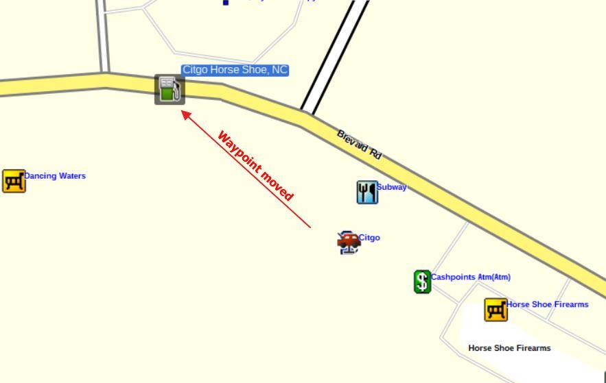

I often do what you describe, not only with potential fuels stops but coffee and lunch stops too. I am going to assume that your gas station waypoints are located off the road somewhere on the property of the gas station. Move those waypoints to the road at a point prior to the entrance to the gas station. That way, if you decide to ride past, the XT considers the waypoint as 'visited'. Make sure the moved point is far enough in front of the gas station so that you are sure to ride through it in even you stop. You don't want the waypoint on the road right in front of the gas station where the XT might think you missed it if you pull into one end of the gas station and out the other end.
I will be back with a picture shortly.
I'm back. In the image below I would be traveling west to east so you can see how I moved the Citgo waypoint so that I should be able to see it when the XT announces that I have arrived and I can't help but 'visit' it when I ride through the point regardless whether I stop.
BTW, if you choose to stop, be prepared for the XT to notify you that you are off route. Make sure recalculation is not set to automatic. I have mine set to prompt so this trick will generate can result in the off route > do you want to recalc prompts. I'm sure there is a "Yes" option but I never see it; I'm too focused on hitting "No".
