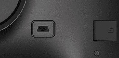

The side view of the USB plug is poor, but I think it shows a mini-USB. Looking at my micro plugs, lighting at that angle shows a single line between light and dark sides, while a mini-USB plug shows a dark line at the indentation bordered by bright reflections on each side.
I found a rear view of the Drivesmart 65 at [url]https://funtreks.com/product/garmin-drivesmart-65/[/url. Looks like a mini-USB to me, same orientation as the XT.
Specs show ample power, so I think it would work.
