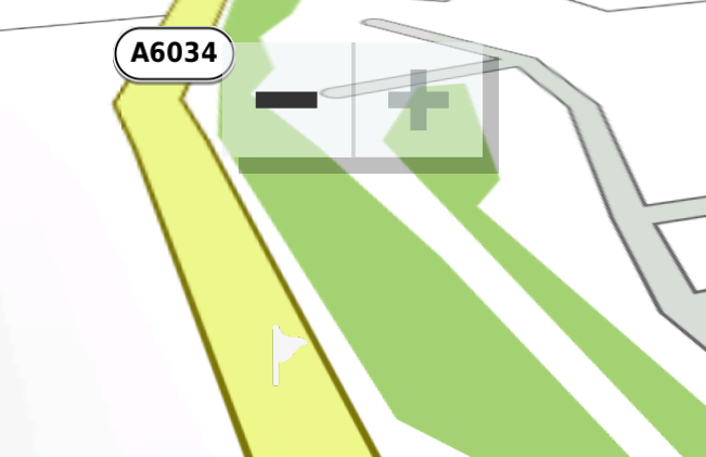

Up ahead places needs to be ticked to show the CustomPOIs. At the time of doing this, the POI shows up as a tiny white flag which is almost invisible.
The image below is a screen shot zoomed in to the max. It is slightly easier to see when it is on a magenta route, but it is still not great. I am going to take a look at the map theme to see if it is possible to change this. It may be better if Explore is set up. I don't know.
It is there, honest - middle of the yellow road, just up from the bottom.
[edit]- so far I haven't found anything in the theme that changes the custom poi colour. Maybe it has to be declared in the POI file itself - I know that you can display pictures and play sounds. Perhaps you can specify an icon.

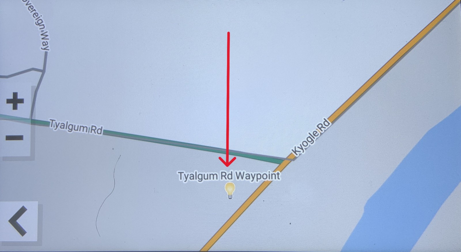

GerIRL wrote: Sat Apr 06, 2024 4:16 am Hi there. A Long shot here - anyone know how to DISPLAY custom POIs on a Zumo XT2?
As you haven't said how you are creating your POIs, I'm not sure if this will help you, but anyway this is to how I do it, when creating POIs in BaseCamp. I don't use the "Tread App" at all with my XT2 and it isn't installed on my iPhone. (Waypoints not POIs might be a more correct term)
When I have finished all my route planning, tracks and POIs/Waypoints in Base camp, I then use the original USB connection cable that came with my XT2 to send all the GPX files, from BaseCamp to the XT2. Once all the GPX files have been sent to the XT2, I then disconnect the XT2 from my Widows11 PC.
I then reboot the XT2. When asked by the XT2, what do I want to install, I use the "Select All" option.
When asked where do I want to store the new GPX files I always store them in a NEW COLLECTION which is given a useful name. IE: "Home To **** Ride". Once all the new GPX files have successfully been installed I can then on the XT2 open the "Explore" app on the XT2, select the "Home To **** Ride" collection and start the route I originally made using BaseCamp. The Waypoints their descriptions and the icons for the Waypoints I used in BaseCamp, will then display correctly on the XT2 screen. The XT2 will also duplicates all your new Waypoints into the Waypoints folder contained within the EXPLORE section of the XT2.
I'll be honest in that I haven't tested this out during an actual ride yet as I have recently torn my calf muscle and I can't even get up on my Honda CB500X for the time being :( But I did however use the GPS Simulator included on XT2 and the routes and all Waypoints seems to work just fine in simulator mode.
Photo 1 shows what a new Waypoint looks like on my XT2 screen. (Red arrow has only been used to highlight the Waypoint)

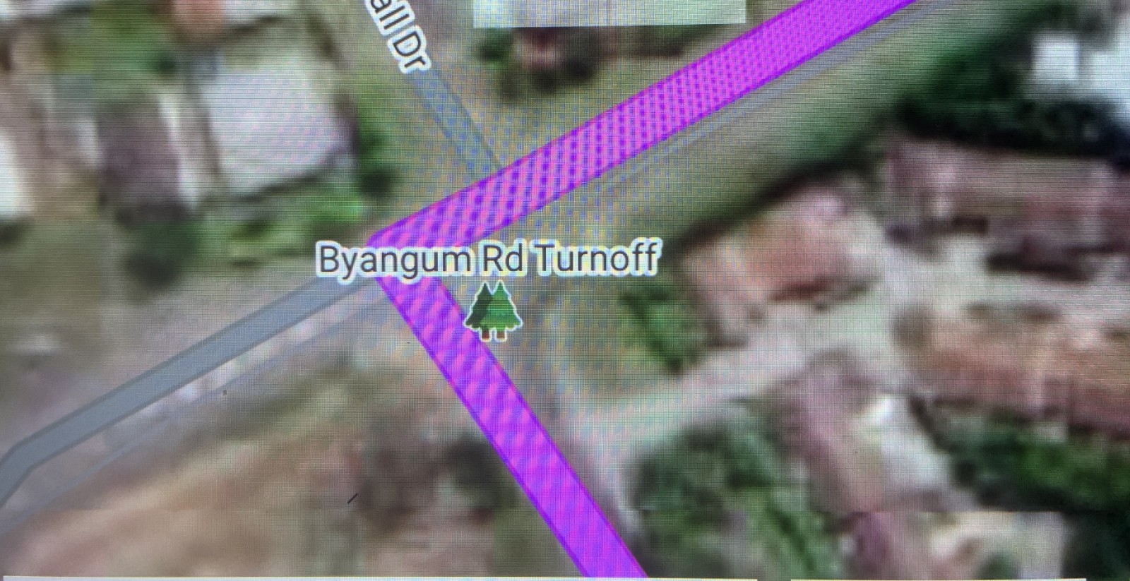

Photo 2 shows what a Waypoint looks like when using BirdsEye view. In this example I've used a tree icon for the Waypoint
Hopefully this info might help you. :)
