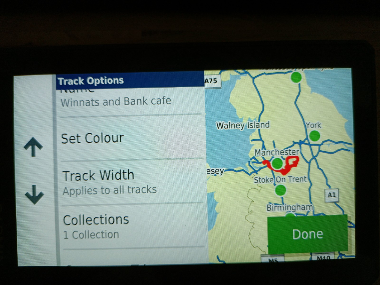

I'm an experienced Garmin user but recently changed from a Nav VI to the XT. I think it would be really useful on my long trips to see the track on the map under the route to spot any odd recalculation behaviour.
I created a couple of collections in Explore and synced to the XT. I added a track to the XT and put it in one of the collections. I was then expecting to see the option (below "Track width") to display it on the map... However that option isn't there? Any suggestions?

The option to display the track is not available if you are using Explore. That's one of the reasons many of us do not use Explore at all.
There are detailed instructions here somewhere to disable Explore, but I think it involves removing the Explore app from your phone, a reset of the XT to restore factory settings, and then bypassing the Explore option during the initial Zumo setup.
You can continue to use Drive.

Thanks for this advice - it worked perfectly.
I did a factory reset and removed explore from my phone.
I tested with a matching Trip and a track it worked just as I had wanted it to.
