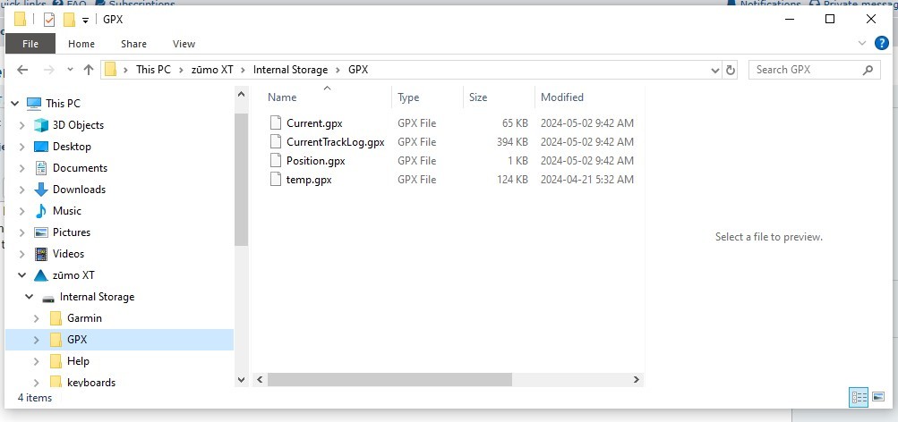

Still having an issue. The tracks are not gone. They are displayed on the map page. They are listed on the Tracks App. They are in the folders when I connect to the PC. They just don't show up on the Where I've Been App. The Where I've Been App just shows the current date, which is greyed out, and any track from today. I checked my buddies XT and it can scroll through the dates and displays tracks from previous dates. I tried a reset with no luck. Maybe I'm missing a file? The reset cleaned out most of the tracks. Here's what's there after the reset.
- 24 05 02 files.jpg (54.64 KiB) Viewed 3391 times
Re: Where I've Been App
Ok - but to be fair, there is no Archive Folder and the CurrentTrackLog.gpx is only 394Kb long - it often gets to between 1 and 3 Mb before it shunts anything out to the Archive Folder.
Check your Settings -> Device -> Travel History If that is not ticked, then it will not record any tracks automatically.
Also if you perform a full system Reset from the same Device Menu - they get cleared out, and you start from zero again.
Once you get them recording - I recommend taking a full back up CurrentTrackLog.gpx and the entire Archive Folder - Every month/six weeks.
