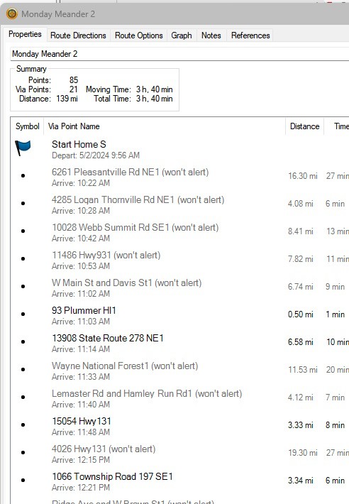

New to Basecamp but I thought I had it worked out.
I thought the "Flags" were "Waypoints" ands the "Dots" were Shaping Points.
So, I was just using the "Flags" (Wayponts) for spots I really wanted to go and then using the mouse and cursor to drag the route when it did not go where I wanted.
Each drag and drop results in a dot on the route. Sometimes I had to use 10 or more "Dots" (which I thought were shaping points and therefore just there to shape the route) to make the route go where I wanted.
That is not a big deal but I found out that the GPS announces each "DOT" (or Shaping Point) as I approach it. With 10 or more shaping points in 10 or so miles that's annoying.
Is there a way to turn that notification off or is that an alternated that will allow be to shape the route without have to put a "Flag" everywhere.

Drag and drop to a location along a road and you create a via point (with alert).
Drag and drop to an intersection and you create a shaping point (no alerting). Don't drop at an intersection where you might actually want to turn.
Open (right click or double click on route name) a route to see and change alerting status of your "dots". Shaping points will show (won't alert), via points will not. You can right-click the point to change the alert status.
Lots more info on the differences between via points, shaping points, and waypoints(flags) here:app.php/ZXT-P04
