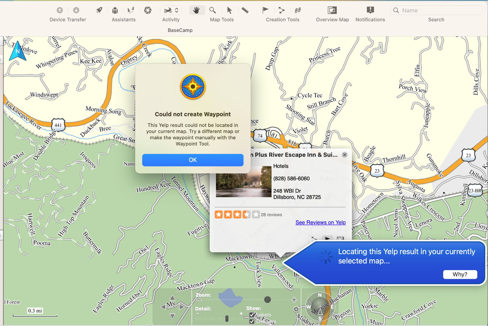

Basecamp Rant - Using Search
Post by carolinarider09 »
I know for a fact that a Best Western exists in Dillsboro, NC. It's the Best Western River Escape. When I did a search for this hotel, it brings back a "Yelp" result but will not let me see the location on the map so I can add it to my route. Yes there are icons on the Yelp thingy but they don't work
And why is Yelp being used. I did give a rat's behind about what Yelp says.
Rant over.

Re: Basecamp Rant - Using Search
The search function in Basecamp is indeed wonky, but the reason you can't find that Best Western is that it is not in the map data. Set the map detail to highest and then zoom in on the location where that Best Western should be and it is not there, nor does it show up in a general 'lodging' search of the Dillsboro area. Neither does the Dillsboro Inn.
I have encountered this before and have dealt with it in two ways. One was to use the Basecamp waypoint tool to place a waypoint and then edit it with the appropriate icon and information. That other was to use the waypoint tool to place a waypoint in its vicinity and then copy the coordinates from Google Maps and paste them into that waypoint, adding any additional data that I want, sourced from Google Maps.
Edit: Disappointing fact: the Best Western in Maggie Valley is not in Basecamp either.
Edit2: I'm using the CN NA NT 2025.1 map on Basecamp for PC.
Thanks for the feedback. I did just make it a waypoint on the road I know it is located on.
OH well.. Just one more issue.
Using CNNA NT 2024.1, Search cannot find the street but will show it, if you know where to look.
Using CNNA NT 2025.1, Search fill find the street and address, but not the Best Western.
Using OpenStreet U.S. 2024-05-18, Search finds the Best Western Plus River Escape Inn & Suites.
Searching more generally for "Lodging", CNNA NT 2025.1 provides fourteen choices within three miles of Dillsboro, the Open Street Map finds nine.
Win some, lose some.
Yelp! results can be excluded with a click on the icon.
Hmmm... :?: I just discovered that Yelp is producing NO results in my BC, for any search, anywhere. I don't often use the BC search function, and don't place much value on Yelp reviews, so this is no great loss.
Still, it is curious.
Though activating two routable maps at once is generally a bad idea, I find that a single search with Where To? on the XT will show results from both maps.
