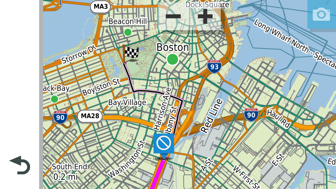

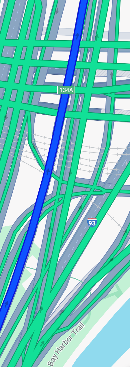

Posts: 353
Been liked: 113 times
Re: My first encounter with phantom road closures
Here is how Google portrays the crazy interchanges just north of where the XT insists the road is closed. I wonder if the complexity contributes to the problem?
Screenshot 2024-11-14 at 8.53.27 AM.png (402.14 KiB) Viewed 2523 times
Posts: 3046
Has liked: 417 times
Been liked: 908 times
I'm putting a cross - top right.
Your turn.
Posts: 353
Good move. My turn. Notice how the route beyond the closure symbol has turned black. WTF?
Posts: 1745
Has liked: 140 times
Been liked: 437 times
danham wrote: Thu Nov 14, 2024 4:49 pm I wonder if the complexity contributes to the problem?
I have seen mine get confused by two situations.
One is parallel roads separated only by Jersey barriers. I can think you are on one road when you are actually on the other.
The other is parallel roads at multiple elevations. The XT just can't tell which road you are actually on.
In both cases, if it thinks you are on a different road than you're actually on you get a recalc response depending on what the setting is. Mine is set to "Prompt" so I get the 'off route, do you want to recalc' popup.
