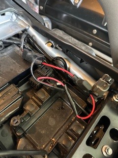

My XT2 powered mount stopped working today and not sure why. My setup has been working reliably for the past couple of years. I have the powered mount taking power off the auxiliary power supply for my Triumph Tiger 1200 under the rear pillion seat - tested power to auxiliary plug and it works. The 3 amp fuse appears to be fine - no discoloration or signs of damage. The ZT2 mount prongs show a reduced power level that seems consistent with the 3 amp fuse setup but unsure on this point The XT2 powers up when plugged into the USB-C cable inside the house but won't power up when secured into the powered mount. Still the XT2 doesn't power up when plugged in the mount. Anyone else have this problem with a set up going bad that had been working fine?

It appears the connectors between the XT2 and the Garmin mount may have been dirty or simply not making proper contact. I popped it back on the next day and it powered on and off with the main bike power as it had before. I found on another forum that someone else had a similar issue with dirty / dusty connections.
My wiring does not go directly to the battery. I use an alternative power setup I found on youtube two year ago that ties the Garmin power cord with waterproof connectors to my 2023 Tiger 1200 auxiliary power unit under the rear seat. I don't need that auxiliary power point, so I unplugged the Tiger power relay under the seat and am powering the Garmin off the relay which is live when the bike's power is on.
