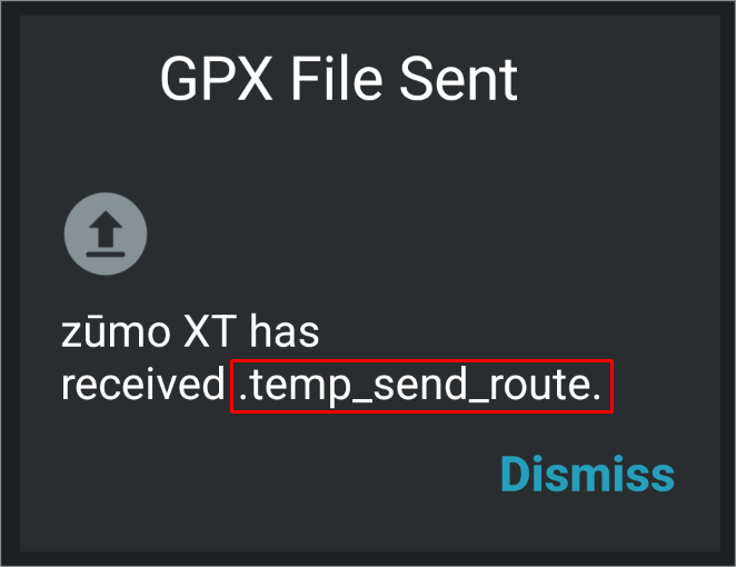

Hi all I'm going crazy here.ive created a route on calimoto.saved to a gpx file.sent it to my Garmin drive app.the app says it's received a gpx file do I want to send it to my Garmin xt.click send.but nothing comes to the xt unit.why and how can I sort this

The screen shot says it has received .temp_send_route. (note the fulls top at the end).
The Zumo XT isn't going to take any notice of that filename - it needs to have the gpx extension, so when you create or save the file in Calimoto it needs to have a file name that the Zumo XT can recognise. Filenames are a name, word or phrase, followed by a full stop, followed by (usually) three letters which are called an 'extension'.
I don't know Calimoto - it may add the gpx extension automatically in which case temp_send_route is a perfectly valid filename for you to enter. It will probably be sent to the XT with the default gpx extension as temp_send_route.gpx
Or you could add your own extension so that you call it temp_send_route.gpx - That will work
But if you add your own fullstop at the end without gpx after it, it will definitely not add the gpx extension.
The zumo will read only files that are something.gpx

It is important that it be saved as a .gpx file as @jfheath said.

Willis7864 wrote: Mon Jun 09, 2025 9:11 pm Hi all .I planned the route on calimoto app on an android phone.saved it to my rides.then sent it to Garmin drive then to my xt.but the xt doesn't seem to pick anything up
.xt is connected to my phone.
Whatever you think that you did, the Garmin Drive App has sent a file called:
As can be seen from the screen shot. It has two full stops / periods int he file name. And no GPX. Even if the file is on the XT (and I am sure it is), the XT Trip app is not going to be able to find it to import it.
Willis7864 wrote: Mon Jun 09, 2025 9:11 pm May be I have to scrap it all and plan the route on calimoto on the pc .instead of my phone
Get the filename issue sorted out first. Do NOT use full stops / periods / . in your file name
unless you are separating the first part of the file name from the gpx part. As in:
First_part_of_filename.gpx
I suspect (but do not know) that Calimoto will add the .gpx to whatever filename you use - so you might not need to add the .gpx
You seem to be in the habit of adding a ful stop / period to the start of your sentences ? But if you put periods in a file name (except the one in front of gpx) that really messes it up for any device trying to find the file.
EXPERIMENT
Do the same thing again twice.
First time, call the file : File1.gpx
Second time, call the file : File2 - see which one is picked up by the Zumo XT.

Hi all managed to do it.domt ask me how.but playing around with my phone I had to send it to my documents and then send it to Garmin drive
